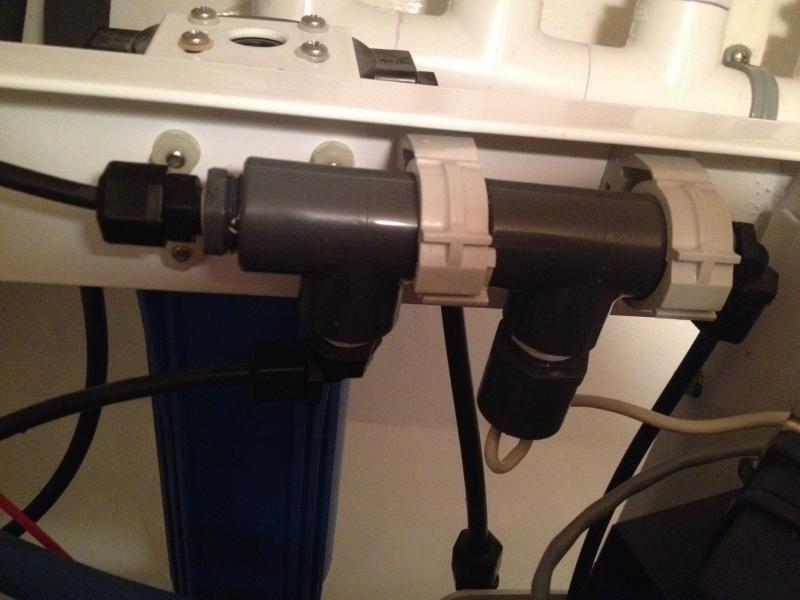

    My day for questions. The salinity probe needs to be cleaned every once in awhile on my watermaker. On mine in order to clean you need to unscrew the probe which has a wire attached. Unfortunately it twists the wire to unscrew it and it twists it to screw it back in and I am sure that it will eventually break the wire. Anyone have a better method.

    Well it must need cleaning again as I show no salinity measurement and have not for awhile. Not sure what you mean it should have two leads and drain. The probe is just one wire possibly two wires inside jacket, not sure. Here is a picture of probe wire and this is located on right side of watermaker. There is a sensor or something on the other side of the watermaker by the raw water filters. Hopefully this is the correct one.

    The whole assemble looks like you can remove it from the hangers, disconnect the 1/4" water tubes then un-screw the probe from the manifold with out cork-screwing the sensor signal wire.

    This one should be just after the filters and a low pressure (vacuum) switch. If your pre-filters clog, that switch will alarm and/or turn the system off.

    Yes I think you are correct. Is there a way to check the probe to see if its working? The idea of the probe is to measure the salinity of the already filtered water correct? And each light represents a 100ppm of sw salinity.
  8. Capt Ralph
    12,727
    The idea of the probe is to measure the salinity of the water after the membrane. It may be quick or several minutes before the water is measured a poor electrical conductor and deemed salt free.

    Looking back at your picture, any sediment in the line, would settle on the probe. Anyway to rotate that T a little to help keep sediment from settling in there?

    I was able to turn the T some so maybe that will help. Its not really sediment on the probes its more like a carbon or something similar. Also found a small piece of Teflon tape that was end there. Maybe now it will be better.
