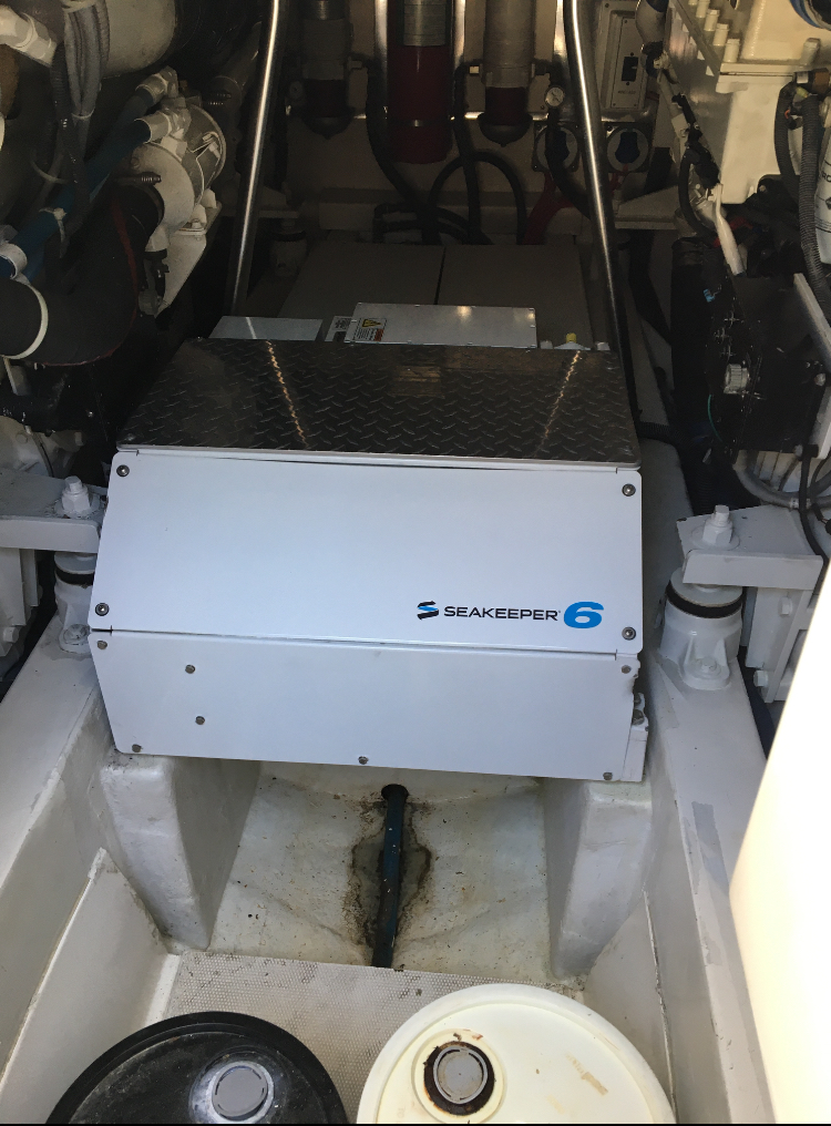

    My Seakeeper went in the engine room between the two engines. It sits pretty low, easy to get over to reach everything. Two extensions were built on the sides of the main stringers to support the Seakeeper. I will try to find a picture.
    Installed cost was ~$60k.
    When planning the install Seakeeper would only provide me with informal guidance. My understanding is they review refit installs with the dealer in more detail. Seakeeper’s guidance to me for more a more detailed formal analysis was to hire a naval architect.
    I was able to connect with Dave Martin the architect for Ocean Yachts, who was retired but graciously gave me some advice. He concurred that placing the SK between the engines would not negatively impact running attitude, CG etc.
    He was a very nice old school guy and suggested toughening up or Dramamine as more cost effective alternatives to a SK. Sadly I believe he passed away last year.

    Here is a picture where you can see the extensions to the stringers to support the Seakeeper. There is a metal plate glassed into the extensions to accept the bolts holding down the Seakeeper.
  10. NYCAP123
    11,209
    Nice clean installation. Looks like it was born to be there.

    From photo it looks like you could have mounted it lower. Is there a reason you did not?

    Keeping CG low is generally good in marine applications, but a gyro should be mounted as close as possible to the axis of rotation, near the waterline and/or center of mass.

    It could have been mounted 1/2 inch to an 1” lower. The globe with the flywheel hangs below the mounting points and there is a clearance spec below it for maintenance. The installer left a little extra room there. If I did it again I would try to save the inch. Climb over it often.
