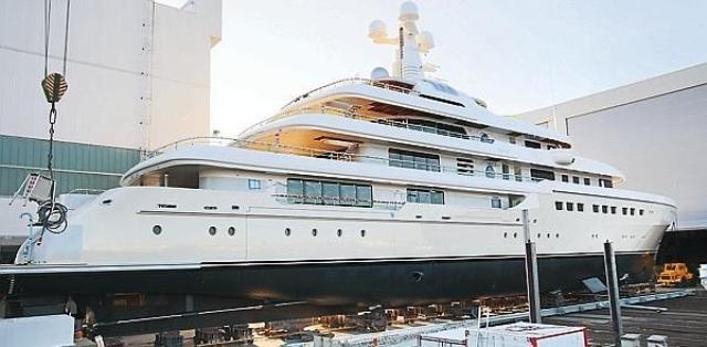

    But those concealed external shafts are not worse the investment. The Magnus effect on a prop shaft is rather neglectable :rolleyes: and costs, higher weight and maintenance issues will never pay back. And as long as the free spinning shaft has no bends or imbalance, noise should be no problem.
    Those Magnus effect tube type stabilizers work pretty well for low speed crafts and when on the hook. But their diameter, efective length and RPM is different from a prop shaft. For a medium sized planning yacht, the electrical Magnus effect stab is a nice and much cheeper alternative than a big Gyro Stab or even more a fin stabilizer (resistance). But only, if retracted into a recess in the hull during planning speeds, which means no stabilization during cruise.
    If you take a look at KIBO on the hard, that is what I would call a long free spinning shaft. But the way I know A&R, it will work pretty well.
    BTW, if you take a look at the keel above the SB prop, you will see the opening, where A&R normally places the pumpjet type stern thrusters on their larger hulls.
