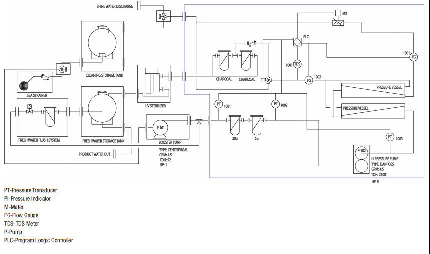

    If there's a soft wall hose on the bypass port, and he pulls the hose off, then the bypass port is free-flowing. That leaves the hose that may or may not be teed to the brine overboard discharge also open. If there is flow from that hose, it is brine overboard. Or, if below the waterline; seawater. Seems like plugging the hose in that scenario would be desirable.
    Looking at this Sea Recovery diagram, and the likelihood that everything is buried anyway, I suggest forgetting about self-testing the diversion valve and simply measuring the output. The output product hose should be easier to find. Maybe.
