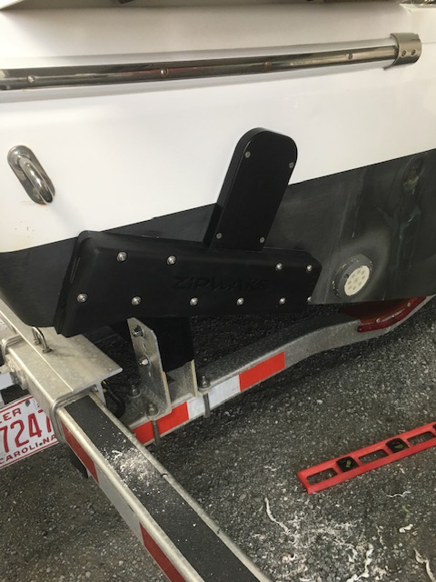

    I went with the zipwakes. $6500 labor and material installed. Hopefully will have boat back in a week or so. Will update the forum when I have run it some.
  8. motoryachtlover
    motoryachtlover Senior Member
    Jan 29, 2007
    693
    smithfield, VA

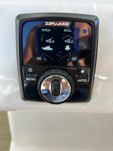

    I had the zipwakes installed. Zipwake recommended the 450S and we went with their recommendation. I have only had 2 days to play with them as my chart plotter went blank in the middle of those 2 days. The chartplotter going down denied the zipwake GPS coverage which takes away the automatic function so I got to use the zipwake system manually which made me use zipwakes like standard tabs. The automatic roll adjustment is a big improvement. Makes automatic adjustments to keep the boat balanced when the wind changes, people move, etc. I did not like the auto pitch control as adjusted as it kept my bow down when going over larger wakes from bigger boats, which led to the bow digging in. I adjusted the pitch to allow the bow to rise higher and it is much better. The auto pitch definetly keeps the bow down when coming on plane. I would like some more time to evaluate the pitch control feature but it seems to be much better but did not do a lot of overtaking larger boats pulling big wakes. So far I like it but is it worth the $6500 cost installed on my 23 footer? I will need some time fiddling with it to answer that.
