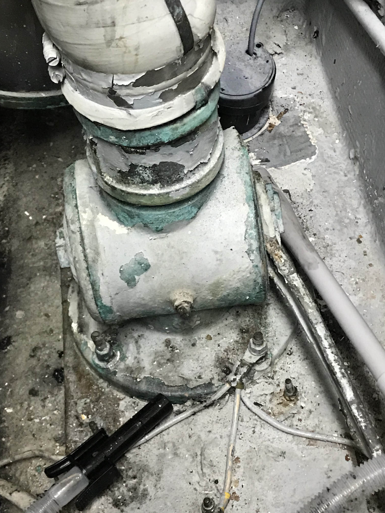

    This is on a 1976 Bertram 58MY
    I would like to identify the maker and type of sea-cock. I would like to find documentation on service and maintenance. I exercised the valves and there is some seeping of water from the edges now.

    Change it, it is 42 years old and past it's useful life. Do the other one as well. It might be an old Groco.

    Wilcox Crittenden. You can see the WC logo near the base of the casting.

    That’s what Hatteras used as well back then. I replaced them all with new.

    Wilcox Crittenden
    I serviced the cocks to my mains. Slowly been replacing all others.

    What the others said, replace them.
    They are good cocks ,but yours is looking a bit ''funny'' green here and there. You said they are now leaking from the edges...

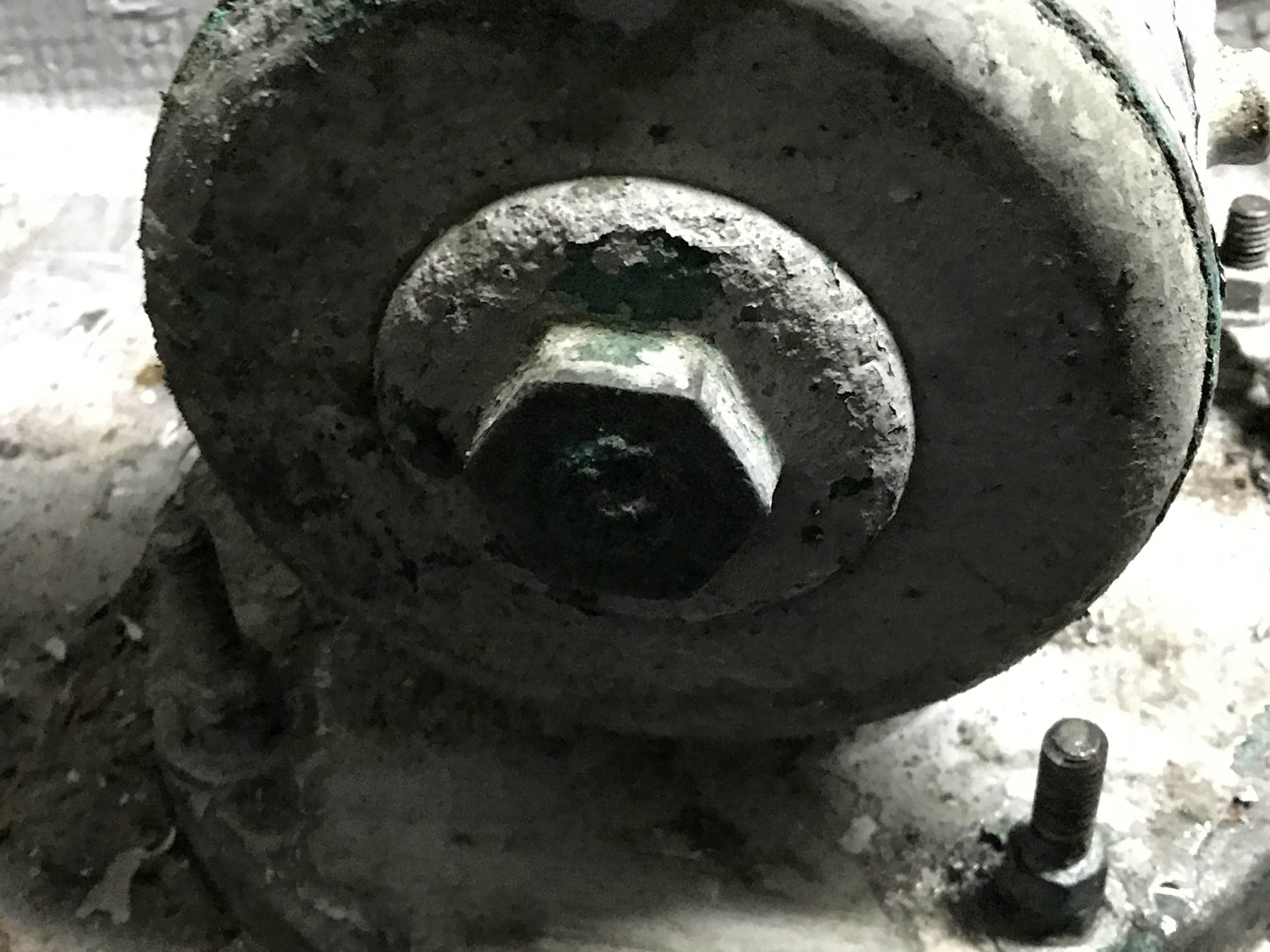

    Until you replace them, and I know that can take a little time, I would spray them with BP Blaster to loosen them up more. This will also help clean them up, with a s/s brush and rag. Spray the nut on photo #2 let that soak for a bit. Now if you snug that nut up the end cap/washer and internal drum should stop the water leak from around the edges. Also if you loosen the nut up, just a turn or so that will make it easier to work the cock open and closed, but will increase your leak until you snug it up again in either the open or closed position.
    Sometimes you have to give the nut end a tap with a hammer on the center stud to pop it loose on the handle side, to get it to move easily .
