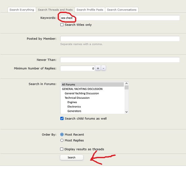

  4. Capt Ralph
    13,436
    Search for sea chest. This brings up every time that phrase has been used.
    More comments come up from other threads.
    Screenshot 2023-04-20 at 12-38-22 Search Threads and Posts YachtForums We Know Big Boats!.jpg
