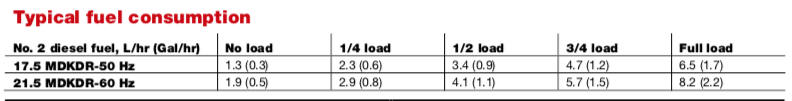

    I assumed my 17.5 KW Onan (Not 12.5KW) generators consume 4 lt/hr. The official specs say Onan 17.5KW consumes 3.4 liters/hr at 1/2 load and 6.5 liters/hr at full load. So given that this is a marketing material at perfect conditions, I assume 4 liters was about right. You can use your own estimation but honestly, I don't think your generator would run with 1/3 of my estimated 4lt/hr, especially under load.
    Here is the official content
    https://www.dropbox.com/s/axayou2rbpepcff/Onan-Generator-Hespera.pdf?dl=0
    The panels produce about 500 amps at 27-27.5 volts during the day. This energy has to be generated somehow. So you can make your own calculation.
