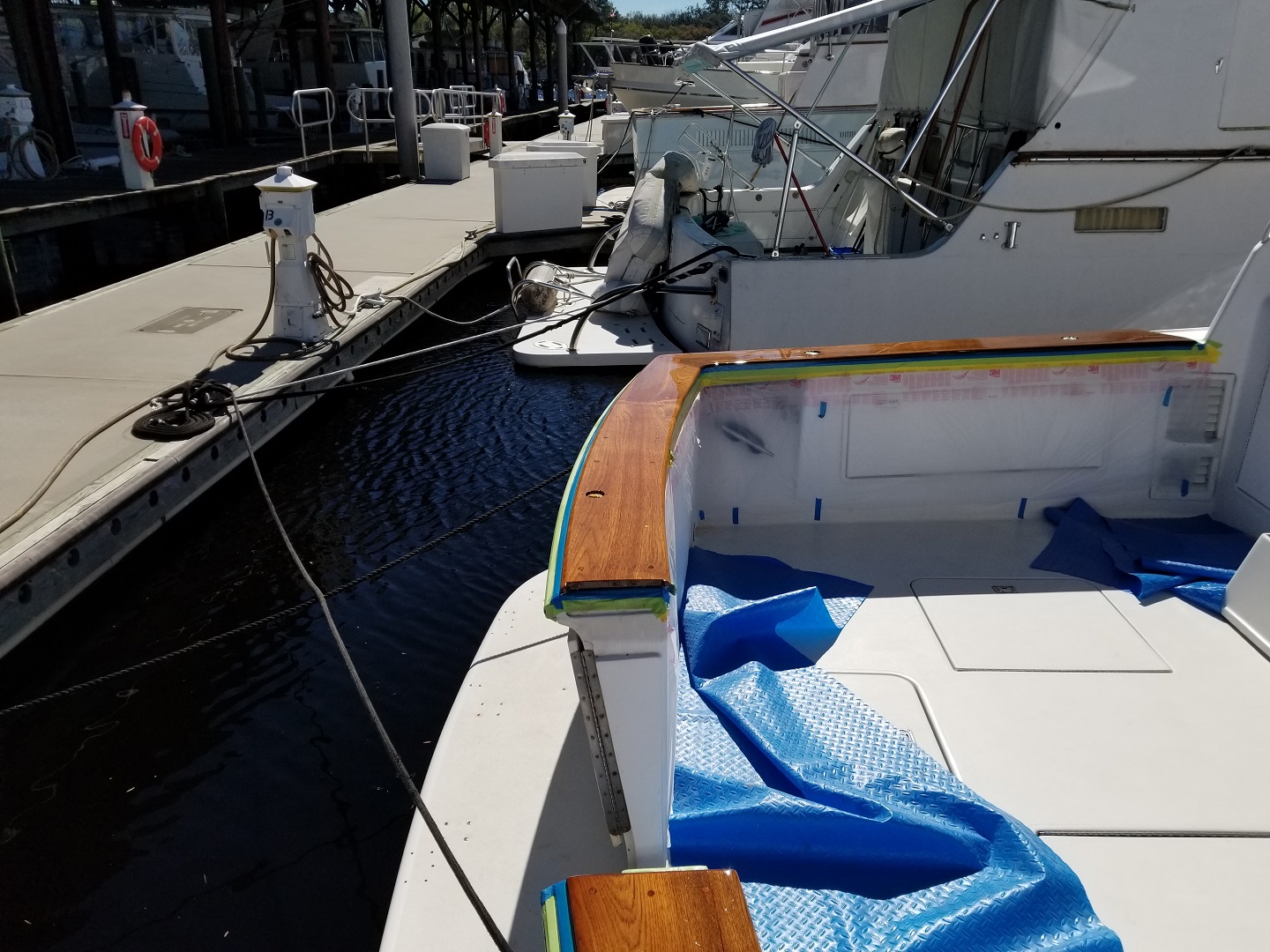

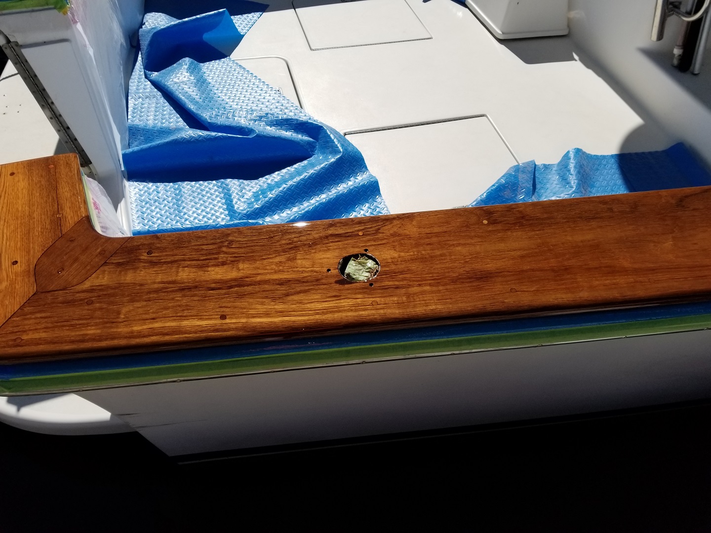

  6. Capt Ralph
    14,523
    Now, If you want a real fine finish, It's gonna take a bit more sanding; 20180302_104048 a.jpg 20180302_104054 a.jpg 20180302_104057 a.jpg
    A couple more coats should finish it.
