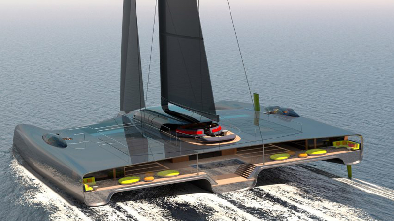

    That's why I came up with this 50 meter catamran with Dynarigg. Upright pushbutton sailing with sufficient comfortable living and deck space. I hope to be able to post the first results of our naval architect very soon. The deriving of the mast forces into the connecting bridge deck is very complicated and requires some very advanced 3D cad and finite element computer simulation and towing channel research with wind force simulation. A lot of expensive R&D.

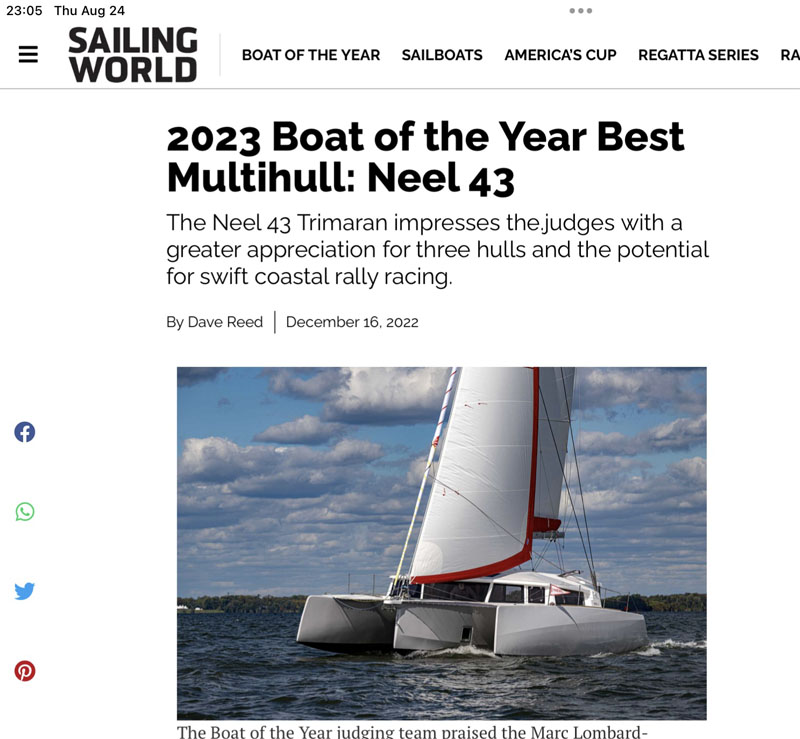

    Yea I can’t handle those guys. Looking forward to their HH but Jason is, well….

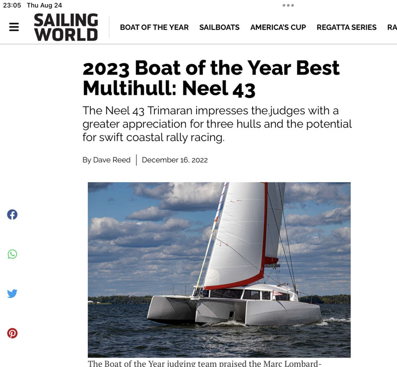

    SLV is building a Rapido 60 which is more akin to the dragonfly tris HTM mentioned above. Looks like she will be pretty fast. Those Neels don’t look that great tbh.

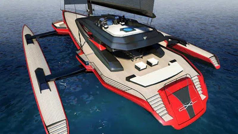

    When looking at larger sailing trimarans, there are not very many examples that please Your eyes. The only one I found, may be this one. It even seems to have retractable sponsons. But I believe, it will be very hard to find a yard taking the technological risk to build that monster.

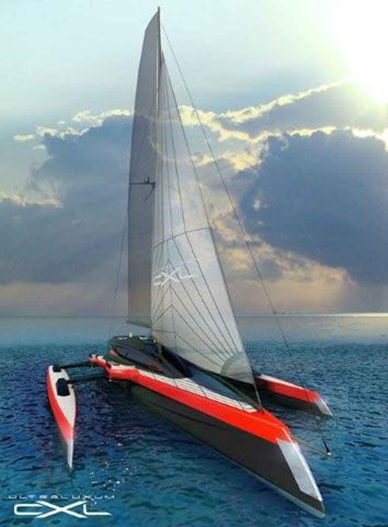

    All others are either very futuristic or just plain ugly. One more example.

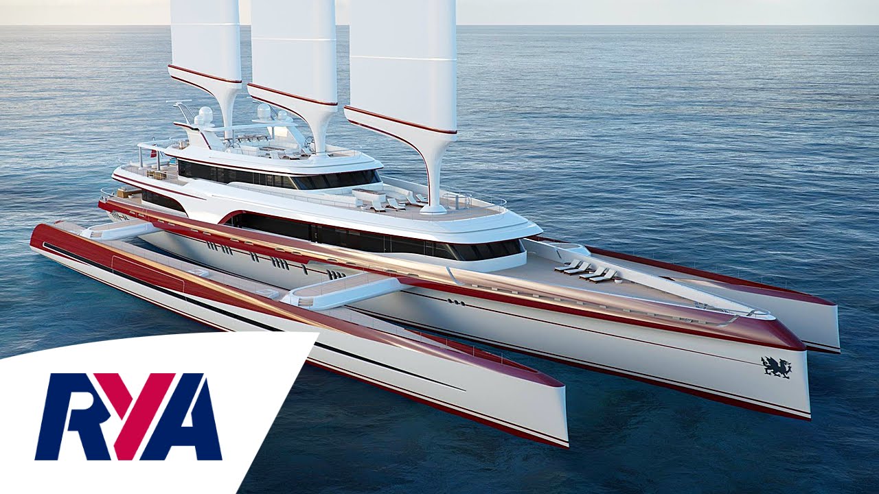

    This one does not lock very practicable and not very pretty either. But the last one is really over the top. A solar sailing trimaran suppost to be fully carbon neutral and bloody fast. I can't imagine the Med mooring fees for tha giant.
    I think, I will stay with that catamaran.
