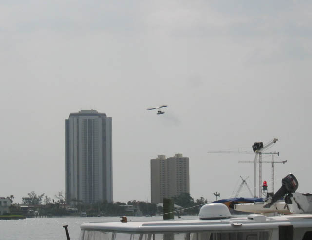

    Speaking of kites, I saw this guy out boating today. Seems like it could be a fun tow-toy for a yacht, IF... the stall speed is lower than the cruise speed. If you're not familiar with these, they are large hang-gliders attached to an inflatable dinghy.
  9. Yacht News
    26,908
    Thats interesting carl, i love to see those flying, maybe those could be an addition to the toys fleet that a yacht has??...what do you all think of that ?
