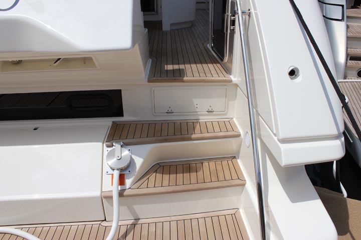

    One of my pet peeves too Belle. During the Palm Beach Show, I nearly performed a perfect face plant walking up these three simple steps. Why? The 3rd step (main aft deck level) is approx. 3" to 4" higher then the first two steps. Isn't there some rule - somewhere - about steps being equally proportionate in height??? :rolleyes:

    Wow....that one is like freaking rigged to kill. I mean normal step, little step, huge step. Might as well tie invisible fishing line across.
    Only way to make that one worse is open that stupid little compartment between the middle and top step. Bet bad enough conditions would pop it open. I mean space is important but a glove like box on steps? For real?

    That certainly isn't ideal, but it needs to be pointed out- that probably isn't a little glove box (I'm making an educated assumption). Rather, it is the end of a passerelle (retractable boarding plank), and is likely enclosed in a waterproof enclosure box. This step height was likely dictated by the smallest height of the passerelle assembly.

    I'm sure you're right....I knew it wasn't a glove box but didn't know what. Now is there any danger of that door flopping open? Or is it electrically or hydraulically sealed?
    And you've explained now the big step but that sure doesn't make it any less dangerous. So I'd still say design problem in my mind. Safety should come first.

    Also, while OSHA doesn't apply to a boat, I just looked at their guidelines. "Riser height and tread width shall be uniform throughout any flight of stairs". Residential steps must be between 4 and 7 3/4" height and cannot vary by more than 1/4". It all seems sort of common sense but someone with the builder of this boat sure didn't have it. I don't even know what boat that is but I would personally not buy it like that.
    I also question making the middle step wider. What if someone ended up standing on it, then decided to take a step down without thinking that the lower step was narrower with the connector? Just all in all a very suspect set of steps.

    I've seen some pretty shoddy and uneven steps on 'Dancing with the Stars', but these ones do seem to get low points.:D
