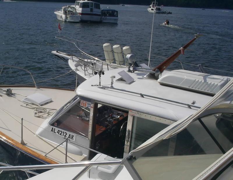

    I added a very low profile unit a few years ago. It has worked out fine. Do get a drain kit for it. (I didn't but should have)
      70.3 KB

    Is that the Carrier Low Profile unit? Annoys the hell out of me that they quit making that unit. (Same one I used)
  6. Laurence
    Laurence Senior Member
    Aug 30, 2006
    248
    Chattanooga TN
    Right you are!
    Right, Carrier Low Profile 15000 BTU Air Conditioner with Electric Heat. Draws 14 amps when cooling. Only about 8 inches tall. I did not know Carrier stopped offering them. Maybe ebay??
