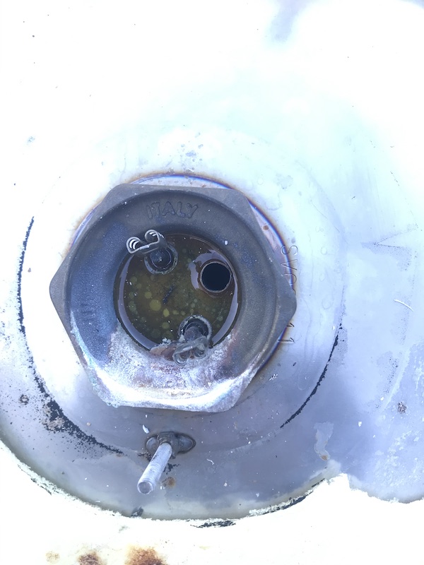

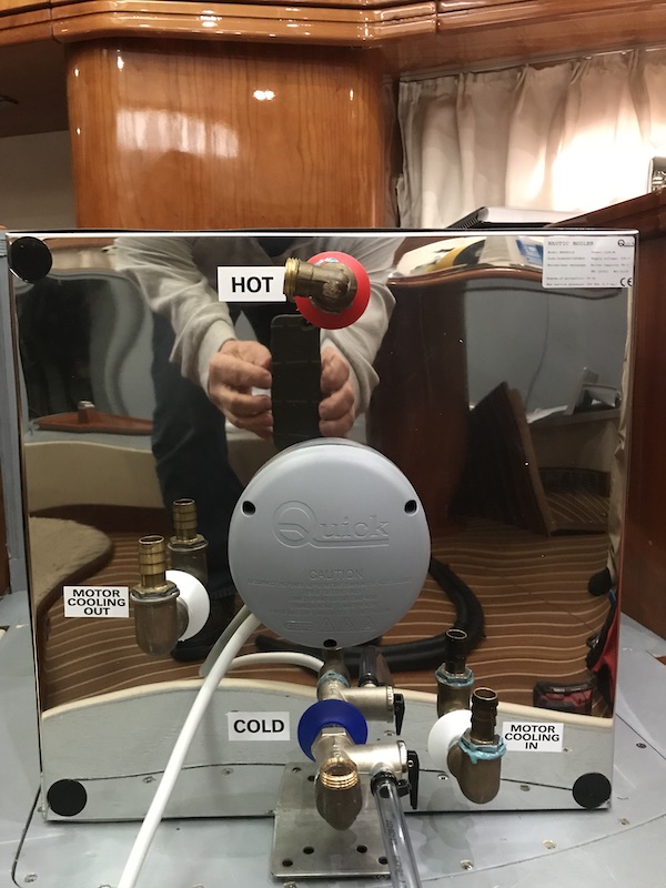

    As the "Chiller" issues are resolved [thanks for all the constructive inputs], a new problem was discovered. The original water heater for the boat, 2011 manufacture, decided to bulge. A new one from the same mfr has been installed.

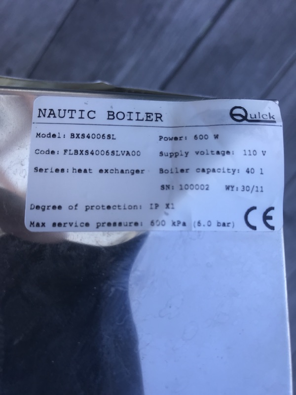

    What boggled my mind was the fact the old one went "over-pressure" and started leaking. It appears from the original name-plate data that it was a 600w/110V unit. However, the heating element that was in it was a 1500w/220V unit. The boat is European built, has 220 & 110. I don't know if owner #1 or 2 did some redneck engineering, or if the Elling boatyard got a deal on 110v units, and put in a 220.
    I don't really know if the water heater vessel is the same for both voltages or not, but obviously the water got too hot & tried to become a steam plant. . .
    Name plate Data

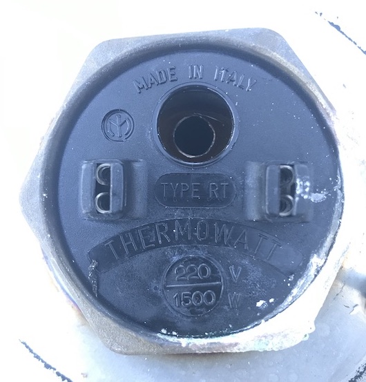

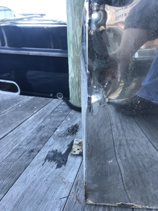

    Heating element in the unit:

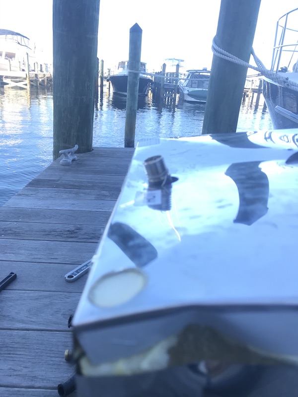

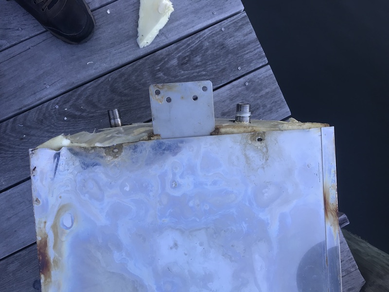

    Bulging of the casing:
    Another view:
    The distortion was bad enough to warp the alignment of the pipe fittings

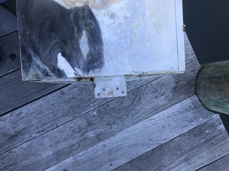

    A view of the overpressure on the water tank itself:
    Another view of the pipe fitting misalignment:

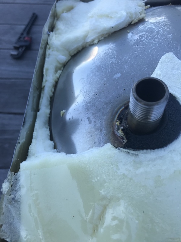

    And the actual leak: Around the heating element.

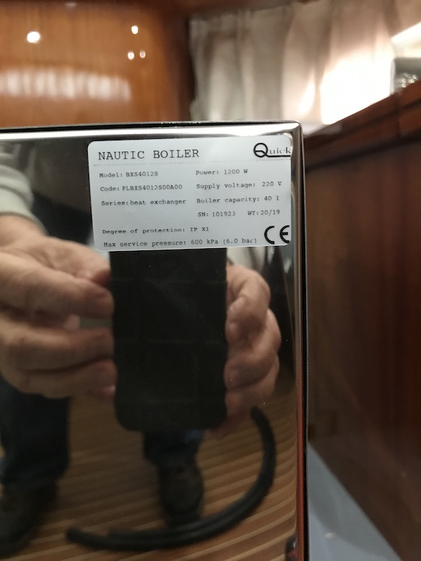

    The new boiler: 1200w/220V
    New nameplate data:
    That's the story. My eyes brow's still reach up to my receding hairline on the old unit's heating element - 1500W/220V in a 600W/110V box!!!

    And even if I can't be positive about this, I believe that the above type of heater is designed to be equipped with an external expansion vase, and THAT should incorporate a pressure safety valve, which I don't think exists at all in the heater itself.
    Besides, in the second photo of the OP there is one part missing, i.e. the stem thermostat that goes inside the hole, and that allows to regulate the working temperature.

    As Mapism pointed out, there was no thermostat control of the water temperature. Previous owner/paid hacker removed it from the circuit? Without a thermostat, the pressure relief would weep/vent with some regularity because the element was on continuously. Same hacker plugged that "leak" by disabling the relief valve?
    A 1500W @220V element would only provide 375W @110V (power varies with the square of the voltage), so maybe the tank construction could live with that heating energy until it couldn't anymore.
