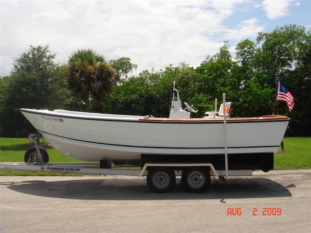

    I recently bought a 1979 Chris Craft CC that was a complete rebuild and repower in 2009. The engine is a Captains Choice 350 V8 with 330 HP. The prop is a 14X11 that I had computer tuned. The shaft and engine were misaligned and that was addressed as well.
    The problem is the boat seems to run bow high and develops a vibration above 2800 RPMs. Top RPMs is around 4800 and the engine is rated for 4800 to 5200. I can lower the bow with the existing tabs, but it labors the engine.

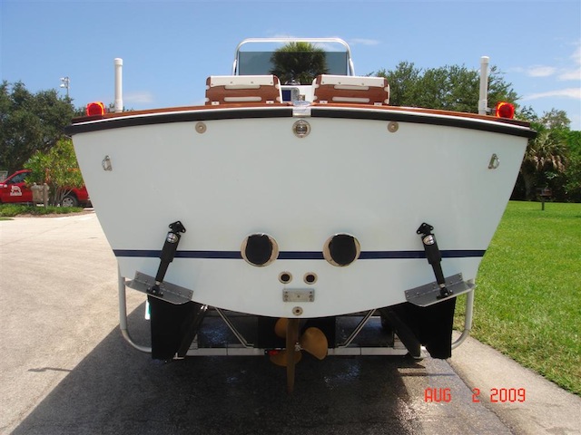

    I am thinking that the trim tabs (Lenco 12X9) are too small and the boat is squatting at speed. As for speed, it idles at 3.5 to 4.0 knots and runs around 38 WOT and will plane out instantly with very little throttle. All the usual vibration suspects have been checked.
    The boat came from the factory with a 220 HP small block and the same prop and rudder size. Don't know the original trim tab size.
    Any thoughts????

    The hull appears to have a lot of rocker in it. In my opinion, the tabs are undersize. It's bordering on a Jersey Speed Skiff. ;)

    The vibration and running angle are two different animals. Has the shaft been checked with a dial indicator? You said the cutlass bearing was worn, hopefully the alignment issue was corrected. CNC scanned wheels are not necessarily the end-all, they usually only measure the aft blade faces and differing blade thickness can sneak by undetected. Try and find a shop that will not only do a static balance but also a dynamic spin balance the same as you would a car tire. I know some of that sounds pretty basic but it doesn't take much to cause vibration at those shaft rpm's.
    A side pic of the running gear would also be very helpful. Too close prop to rudder clearance can cause blade pulses to be transmitted through the rudder stock. If the prop clearance isn't at least 15% of the blade diameter, in this case just over 2", then I'd suggest adding cup if it doesn't already have some. It may require removing some pitch though since you sound propped right at the edge already and freeing up the engine is always a good thing.
    The bow high running angle isn't a suprise with that rocker, actually I'd have almost expected some porposing. Wider and/or longer chord tabs will definitely help bring the bow down and reduce the drag you get running smaller tabs all the way, they start acting like speed breaks.
    If she is bow high at all running speeds a small bottom change may be a better idea than new tabs. Adding a wedge to the aft running section is relatively inexpensive and can change running angle with less drag than tabs and still leave you the option of using them when you need to lower the bow and punch through some chop but keeping the bow up in following seas. An old trick to decide if a wedge is in order is to stretch a VERY tight 1/4" piece of line from aft cleats, under the hull just ahead of the transom. Obviously this has to be very tight to stay in place but if it breaks her over, you can haul and add a epoxy/cabosil wedge with very little effort and leave everything else as is.

    I am leaning toward larger tabs and isolating the mufflers which are under the deck just behind the helm seats. The tunnel between the stringers is narrow as the stringers were beefed up as part of the engine upgrade. The mufflers are 4" dia. and are bolted to the hull with a four inch wide aluminum strap around them. There is no damping between the mufflers, clamps, and the hull.
