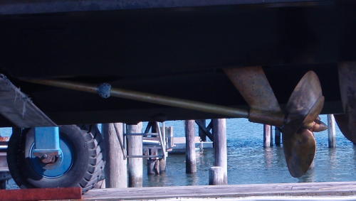

  16. rocdiver
    rocdiver Senior Member
    Oct 24, 2006
    191
    Ft Lauderdale, Florida
    Propspeed is GREAT!!!
    This is 5 months after application of propspeed. From Ft Lauderdale to New England on her own bottom, then based in a very quiet marina (not much flow) on the Jersey shore. Running about once a week somewhere in New England.
    Still good coating and not a bit of growth. I LOVE it!!
    Ditto with the bowthruster!
    ROCKY
