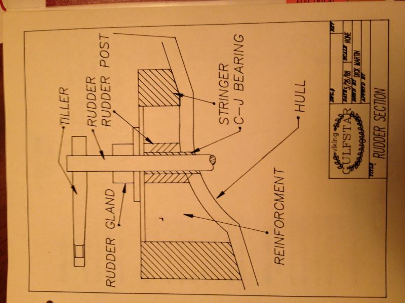

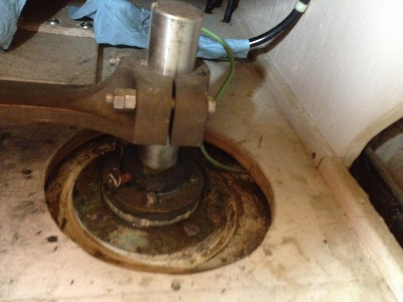

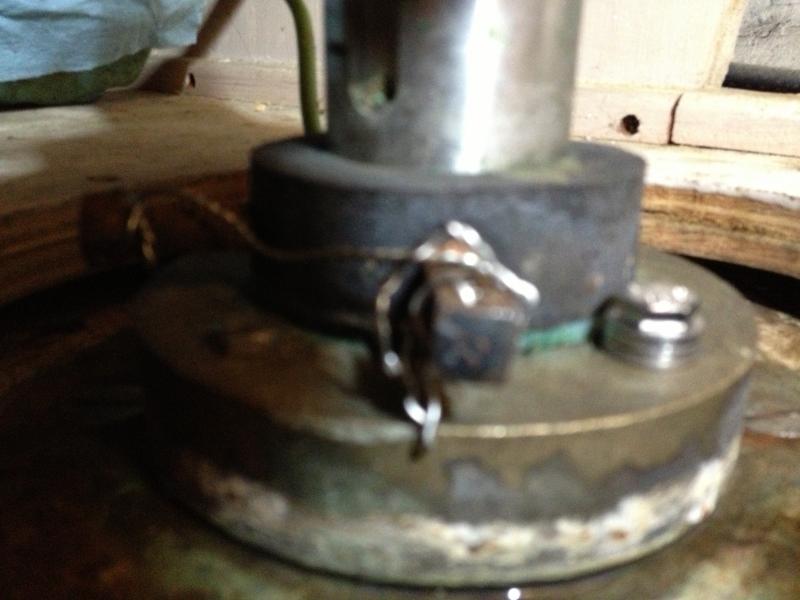

    Those photos and the drawing are not the same item.
    The upper ring with the square headed set screw looks like a low-rent shaft collar type of retainer and thrust bearing more than a "packing gland" as there does not appear to be any means to tighten the "gland" and compress packing against the shaft.
    Does the lower ring with the 4 bolts rotate with the rudder stock or is it fixed to the plate with the countersunk fasteners?
  12. captainwjm
    captainwjm Senior member
    Aug 17, 2010
    296
    Miami, FL, Cape Elizabeth, ME
    Actually the drawing is pretty close, just not detailed. The top is a retainng collar. Under the retaining collar is the packing gland that bolts to the sole; inside that packing gland are the two fiber rings that I inquired about. We lifted both the retaining collar and the packing gland to expose the fiber rings [we blocked up the rudder using a jack and the tiller arm]. Since we couldn't remove the fiber rings, we added a layer of packing gland material above the fiber rings - inside the packing gland - and bolted it back down again, which lessened the seepage - so we're on the right track. So the question is, do I need to replace the fiber rings, remove the rings and replace with regular packing gland material, or add more packing gland material on top of the existing rings?

    I've spent about 40 years around boats and I have never seen anything like that. The drawing appears to show a regular gland nut with the packing inside the nut that compresses when you tighten it. I think your biggest problem is finding the rings. I can't see how a conventional packing material that is wrapped around the shaft is going to last for any length of time. Is that the bottom of the hull in the picture or is the hull built up around the rudder shafts where the plate is fastened to?

    Those four bolts appear to be very close to the shaft/stock so how can the packing compress against the shaft if there are bolts in the way?
    The packing has to seal both the shaft/stock and the face of the plate to which it bolts. It would take something like an O-ring seal between the shaft and the "gland" plus another mounted between the gland and the plate to which it is bolted in order to seal the shaft. If you just seal the face of that gland to the plate there is nothing sealing the shaft.
    Look at a drawing of a conventional shaft packing gland and you will see what I mean. What you describe is only half a seal.
  15. Pascal
    8,546
    So the 4 bolts compress that plate which in turn compress the rings against the shaft and housing?
    If that s the case the you could replace the rings with conventional packing material...
    I wonder about the safety wire on that bolt... Why is that collar so critical to require a safety wire if the compression and sealing is done with the 4 bolts.

    As to Pascal's question: "I wonder about the safety wire on that bolt... Why is that collar so critical to require a safety wire if the compression and sealing is done with the 4 bolts." It appears that that collar is only to secure the rudder if the tiller arm needed to be removed. Viking says that if it and the tiller arm are removed [which would be the case if I had rings to replace] the rudder would need to be blocked from below. As it is, there are dimples on the shaft corresponding to the bolts in the collar that are safety wired. So, it dosen't appear to be a critical piece, but a redundant one to keep the rudder from falling out.

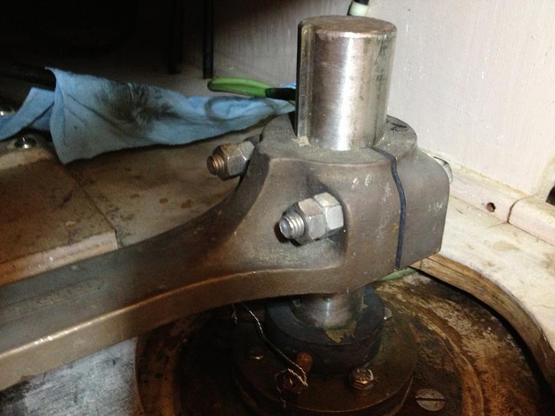

    I don't see any need to support the rudder from outside, just tie the tiller arm to something that will take the weight and prevent the thing from falling out of the boat. It looks like there is plenty of room to lift the collar and "gland" to replace the packing.
    If you plan to do this very often, drill and tap the top of the stock (shaft) and put a ring bolt in for lifting/holding purposes.

    Marmot, that's exactly what we did. We used a screw-type car jack to support the tiller arm and had about 3 inches of space to work with after we lifted the collar and "gland." Since we were unsure about removing the solid rings we just added a layer of regular packing above it to give the "gland" something additional to press agaisnt. As I mentioned before, that slowed the seepage, so now we know what to do going forward.
