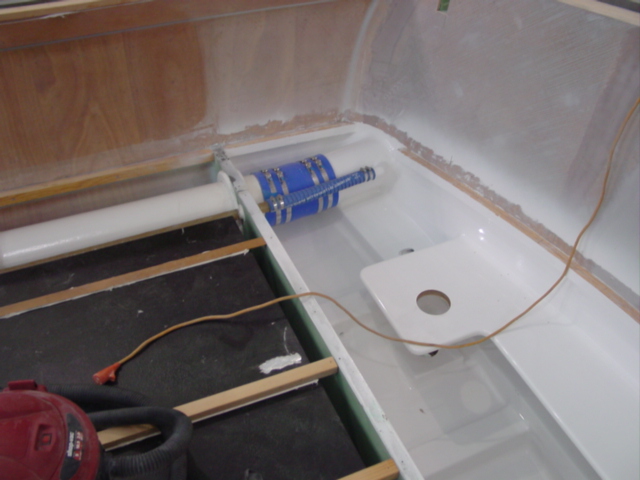

  12. Bill106
    Bill106 Senior Member
    Jan 9, 2010
    390
    Beaufort NC
    That's actually two separate pieces rcrapps, the transom tube is glassed in and the "tube" is a linear muffler. This is the same thing on the 64' "Still Kickin" from that other thread. (I hope I resized it correctly Carl!)
  13. Capt Ralph
    13,440
    Ah, That is a muffler. Got ya now.
    Still thinking, can you do away with the hose and clamps? The linear muffler looks glassed in or near permanently installed. Glass it all in and reduce an inspection/maintenance item, those clamps and hoses.

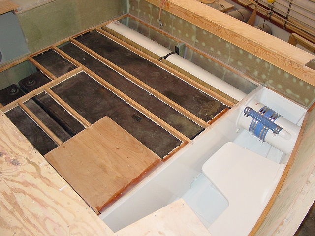

    pascal, on my 58yf the tube is glassed in to the transom, it is only about 8 inches inside the transom then a short piece of hose then glass tube, the second length of tube is connected with a short piece of hose. from the factory the glass tubes are within one inch of the other but the hose piece is 18 inches long at the connection. be sure to use the ss crush sleeve from centek inside of the glass so it doesn't crush at the clamp area
  19. Scallywag
    Scallywag Member
    Apr 25, 2012
    85
    Islamorada FL
    Hey Pascal, for reference on the muffler/no muffler issue... If you remember, Panacea has the exhaust elbows dump right into the un-baffled 15 foot splash rails (aluminum of course). No muffler on Cummins the 6CTAs. Ride isn't whisper quiet, but quiet enough and practical.
    Added photo for reference.
