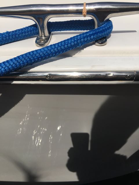

    I've got some minor dents in one section of rub rail. The boat rode up on the piling fenders at king tide. Anyways, they're not bad and they are all in a 15' section. The rail is standard 1" x 1/4" with 6" center countersunk holes.
    I've only been able to find 12' sections which means I'd have to put another joint in it which I don't want to do. Can any body hammer this out in FTL or is it always a replace? Thanks.

    Try G+S welding, they're back behind lesters off of 3rd ave I think it is.
  3. Capt Ralph
    14,523
    Replace it with solid D bar, not the hollow D bar that dents in.

    Yep, that's the trick for stopping dents. I don't know why Post used hollow D bar on lots of their boats. You see a lot of them with little dents around the wide part of the bow flare.

    Agree on solid rails, I installed those on my sailboat and after 10 years they looked brand new despite my attempts at denting them every time I docked:)

    Well, there is an advantage to hollow. If it gets hit, the rail will dent and may not transfer the shock to the hull and damage the hull. Obviously, a heavy hit may damage the hull both hollow and solid. Dunno, hollow may be better - or not. I would rather replace the rub rail than fix the hull.

    A solid D rail will protect the boat better.
    If a hit gets past a solid D rail and hurts the boat, it was one heck of a hit.
    Lets reviewed the only advantage of a hollow D rail; IT'S CHEAP.
    So you can replace it more often.
    My 1978 Bertram has solid Original D rails.
    No dents and I lean on piles often.

    It's a rub rail. It s supposed to rub and you're supposed to be able to lean on it. Shouldn't be hollow. And yes the structure behind the rail should be able to withstand pressure and the occasional reasonable hit without cracking or leaking
