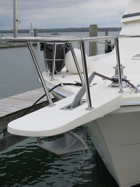

    I am looking to upgrade the anchor on my 89 Viking. I would be looking for a rocna or similar. But I don’t know if any of them fit in the factory roller without modification. Anyone know?

    I have a 1988 Viking Motor Yacht and the previous owner put a 25 kg/55# Rocna on it and it works. I do not think it required any mods. We have spent several days this summer and last and have not dragged even in a few windy days with 30-40 mph gusts on Lake Michigan and Lake Huron.
    We have 5/16 g4 chain s d in the original factory spec and option list from summer 1988 that is the size chain listed. I have an original copy of the list. we have an Ideal windless.
    Hope that helps.

  5. LM Viking
    LM Viking Member
    Sep 20, 2018
    151
    Michigan
    Yes. Original Rocna. Hope the picture helps.
