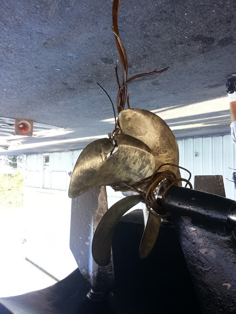

    The attached pictures shows a 29 x 27.5 Veem Prop that that hit a deadhead in the Pacific northwest. The one blade is bent and is ripped, my question is does any one know of a prop smith that can straighten and weld this prop such that is could be used as a ATT_1418920030333_20140928_095130.jpg spare slow speed get home prop?

    If were in BC , Osborne Propellers in Vanc. are the experts.

    Osborne Propeller in Vancouver came back with a very good response, they said they were certified to weld Nibral. The owner is in the process of sending the prop to them for repair. Thanks to all and especially Dennismc.

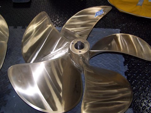

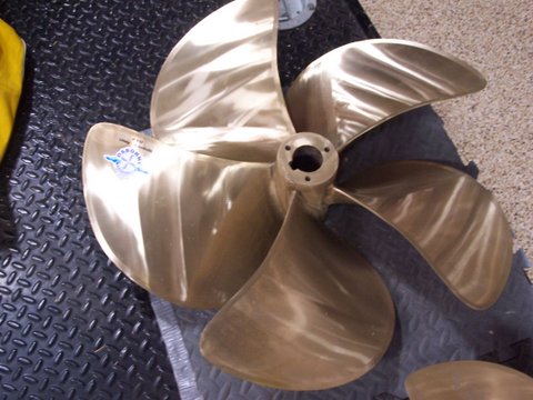

    All: Got the props back last month and Osborne Propeller did a fantastic job on the complicated repair. Thanks Dennismc for the recommendation. Here are two pix of the finished prop. The repaired prop looks identical to the matching prop. Both pix of the repaired prop. Thanks again.
