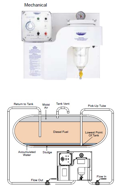

    Is fitting the following Reverso diesel fuel polishing/filtering system an advantage on a yacht which is already fitted with a Racor turbine series duplex fuel water separator unit as primary fuel filtration?
    I believe the Reverso system is just another standard fuel water separator which does the same job as the Racor turbine series primary fuel filters.

    In that picture it is setup very much how a normal F.O. Separator is setup. By continual re-circulation you will remove a quantity of the junk in the fuel, with a F.O. Sep is it just a case of cleaning the bowl when it gets dirty, with this filter system it means changing a filter. You could look at this as a first line of defense and run a filter that is a bit larger than the next one in line and so on. So if you run a 20 micron one in that , a 10 in your Racors and a 5 or less in the secondaries you will extend your filter life. I am doing one now where we will run twin F.O. Separators 24/7, all fuel used will have been re circulated through these things. The engines get their fuel after it travels through an engine manufacturers Coalescor setup and then Racors followed by on engine secondaries. The returns go back to the tank and the whole process starts again.

    With all due respect that's not how you use the Reverso system. The reverso sytem is used either as a transfer pump/filter to pump and filter the fuel when pumping from one tank to another tank, or simply to re-circulate the fuel in the same tank. It does not feed the engines and is never to be plumbed "in-line". SO, you want to run a 2 micron filter in them to remove as much algae,water,etc as possible each pass. The reverso system does not supply fuel to the main engines or filter the fuel going to the main engines through it.
    TK- yes they do work very well at filtering fuel and removing water from fuel or as a transfer system (which is how I see them plumbed many times) on a boat that doesn't have enough fuel capacity to warrant a centrifuge. My only gripe with them, is I wish they used a Racor turbine filter instead of a separ due to the ease of changing racor elements and the price of the element. With 8000 liters of fuel, if your not worried about the cost of an Alpha that would be the best way to go, but the Reverso would work fine as well, and is a nice setup, for that amount of fuel as well. It has a timer that you can turn it on and set it up to about 12 hours of run time and just let it go by itself if you're just re-circulating fuel.

    I have decided to fit a single 210 GPH Reverso fuel polishing system. It will pick-up fuel from one tank and return it to the second tank. Both tanks are connected together with a balance pipe.
    Thank you for the input.
