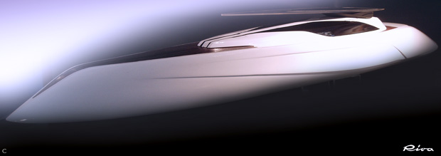

    Reverse bows, is it a new trend in yacht design?
    Like this Gatsby styled laid back cruiser...
    Opinions?

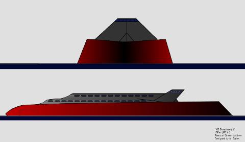

  7. Whiteho2
    Whiteho2 New Member
    Feb 10, 2007
    6
    Birmingham Navy
    This was my Coventry University Final Project. Indeed the initial idea for the reverse bow was a styling element but this 50m yacht was designed to be fast so her bow would raise at speed. The previous thread was correct however in saying that youd be drowned if standing on the forward deck area when in motion.
      46.3 KB
      7,041

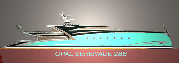

  10. MikeUSCG
    MikeUSCG New Member
    Oct 20, 2007
    Northern Virginia
    Reverse Bow
    In my opinion, the style of a reverse bow is worth any mild drawbacks in handling. This is what i drew up this afternoon; forgive my art skills, please.
