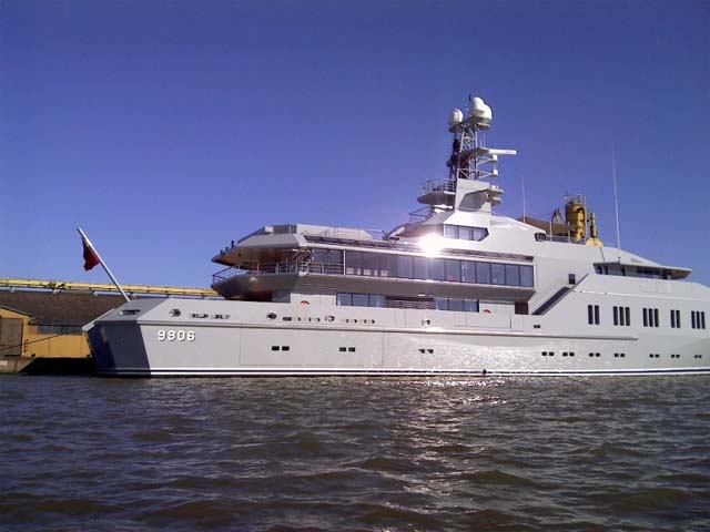

    Its only a handrail, not a real classified guard rail.
    A similar retractable handrail you can find on SKAT (Lürssen). On each side of the helipad there is a handrail with 4 stantions, but no rail wires.
    In my picture I shot in Brunsbüttel (Kiel Kanal) the rail is retracted (attached below)
    On Flickr I found a good picture with the rail in normal mode (photo by Dominique Pipet)
    http://www.flickr.com/photos/11765034@N02/2924386021/sizes/o/in/photostream/
    There you can see in the left corner of the handrail a little diagonal bar, maybe the connection to a hydraulik or electrical drive
