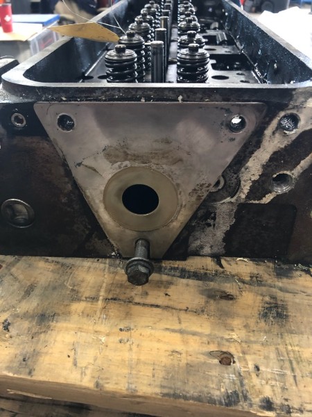

    I cracked a head recently and my DD expert has never seen anything like this before. Is this normal? Do we need it or should it be removed?
    It's the second cracked head I've had on this engine.
  2. Capt Ralph
    13,443
    Run your serial number for the part breakdown for your engine. Determine if this plate is in that part list.
    Does your other engine have this plate?
    What HP tune?
  3. praetorian47
    praetorian47 Senior Member
    Aug 22, 2011
    258
    Bayport, Midland, Ontario
    750hp. I can't tell if the other has it without pulling things apart. It wouldn't be on the DD parts list. My DD expert buddy was a DD mechanic and ran service for Harper Detroit up here for years. He's spoken with other old experts and nobody ever heard of them used. Our plan is to keep them but remove them.
  4. Capt Ralph
    13,443
    Tell more about the crack; Between the valves or water jacket over the exhaust?
    Heat or fatigue issue?
    First replacement head was used?
  5. praetorian47
    Aug 22, 2011
    258
    2 cracks on this one, between the valves.
    I believe it's a heat issue - but I'm certain it never exceeded 200 on the gauges. I've got a murphy gauge on that engine, so when I check that it was even lower (I've never seen that hit 180 - but that doesn't mean it doesn't, it just means that by the time I run down there, it's not).
    Last year I replaced the inboard (port side head) with a new one. The one I've got to replace the other is new also. They were moving parts from the old head to the new one when they saw this restrictor and can't figure out why it's there.
  6. Capt Ralph
    13,443
    Between the valves IMO is fatigue.
    Mostly 4 valve heads on 92s. I have witnessed it often.
    Early this year on a 53.
    Ship Happens.

  10. Capt Ralph
    13,443
    It is a 92 head. Just making sure.
    At 750HP in a TA config,,
    Yep; fatigue..
    Not overheating.
    Your also J&T or SS?
    I'd leave that plate in then. Slows the coolant flow down just a bit, ensures the after-cooler gets max cool coolant from it's own HE.
  11. praetorian47
    Aug 22, 2011
    258
    Thanks! so I should leave the restrictor plates in there?
  12. Capt Ralph
    13,443
    Yep.

  19. Capt Ralph
    13,443
    I found an IPB on another web site. The plate is original.
    The picture I found is copy righted and can not be posted here.
    Yep, Keep the plate.
