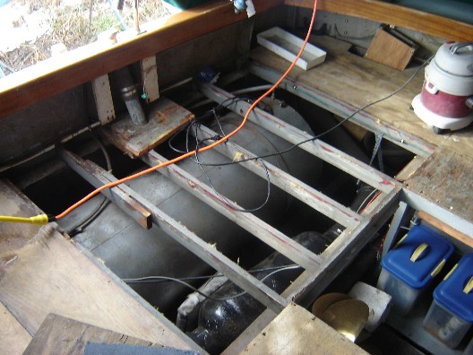

    Me? I'm changing out the 37 year old gas & water tanks - this after the water tank "broke out" bottomside this summer. Couldn't imagine what 100+ gals of fuel in the bilge would have been like, and don't ever want to.
    Hey, it gives me a chance to "firm up" the aft deck as well - in preparation for a new TEK-DEK surface layer.
    America - land of opportunities! :D
    Here's the going-in shot:

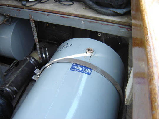

    ...., the new starboard gas tank!
    (116 vs 110 gals/original). :D

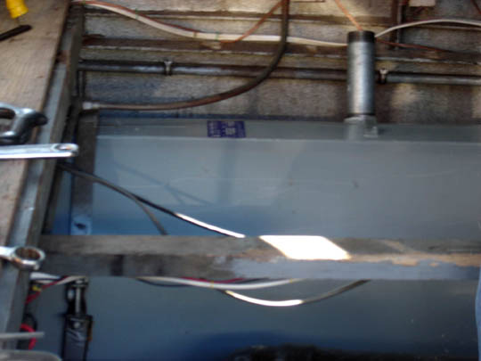

    And later...
    ...new port gas and rear water tanks. :p
    Atlantic Coastal Welding did the job - nice work ($2900).

  4. YachtForums
    20,610
    Most projects turn out to be bigger than you expect. Kind of like the pics you posted above. :p (reduced 'em to 540 pixels)

    Did the company that did the welding have to add baffles to the fuel and water tanks? What is the material you used?
    Mark
  6. alloyed2sea
    alloyed2sea Moderator
    Jan 28, 2004
    872
    Alex, VA
    New Tanks
    They're aluminum, fully baffled - and slightly larger than original advertised tanks of 110 gals.
    Water tank had no similar plaque identifying all key variables such as size, but looks exactly the same.
    Had'em made as exact replicas - all the better to fit on the original supports/straps. Kept the thin non-carbonic gasket underneath those straps - just in case (the old ones were galvanized steel).
