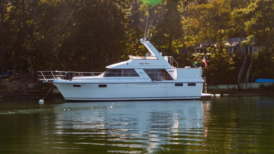

    I recently purchased a 1986 Carver 4207 and the port engine has low compression (35psi) in one gf the cylinders. The other cylinders are 120 psi. The mechanic recommended replacing the engine. he said that he can get a plug and play engine for 6 k, and it would be another 2k to install it. In order to lift the engine out of the vessel, and replace it with a new one, he said that it would require cutting into the floor. It's about 3/8" flooring. The engine room is normally accessed under the stairs, but getting a hoist in there is impossible. The starboard engine has been running fine. We mainly use it as a floating condo for our family this season, and are considering replacing the engine next year. The engines ran well during a 100 mile trip last year before this happened.
    Does anyone have any experience replacing an engine on a 4207?
    Any thoughts, or recommendations?
