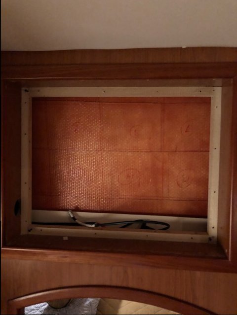

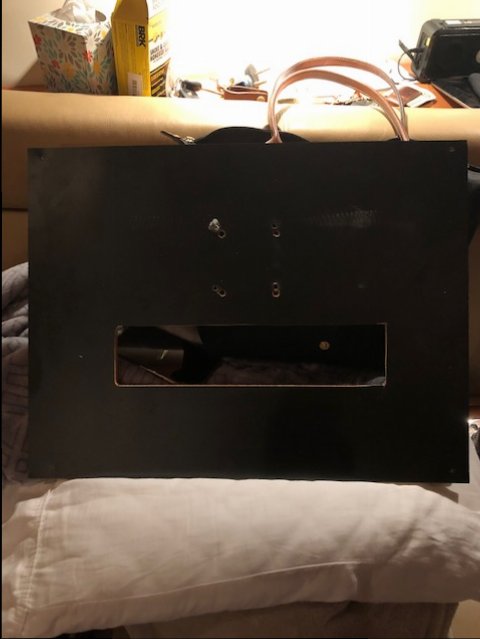

    I thought I'd post this here for anyone wanting to replace their TV. We just bought the boat and one of the first projects was to replace the TV, which didn't have a digital tuner or streaming. I thought it would be an easy project. I was wrong. I assumed the TV was mounted on a standard flush mount. Because it was trimmed so nicely with framing inserts, I assumed it had to have a standard pull-down release for the mount because there was no way to get to a screw release. I tried and tried to find and pull the release. It turned out that the "release" I found was the plastic wire wrap for gathering up extra power cord. There was no mount, presumably to save the cost. The TV was screwed to a plywood panel and the plywood panel was screwed to a frame inside the nicely framed opening. I couldn't see the screws holding the panel until I removed the trim. IMG_4131.jpg IMG_4132.jpg IMG_4084.JPG

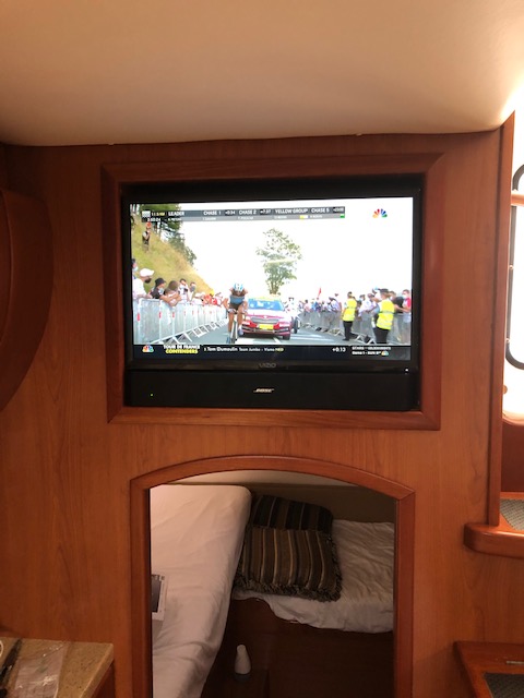

    Here's how the new install turned out. Added a soundbar to fill the gaps created by removing the trim pieces.

    Sound bar filler, great idea.
    Looks real nice
  4. Capt Ralph
    13,443
    Wow
    Without major cutting up around the hole, you put in a perfect fitting system.
    Don't break your arm, but serious back patting is deserved.
    Please keep us up on your projects. Careful with that arm.

    Thanks! I got lucky and found a TV that was .1 inches narrower than the opening. Measured and drilled very carefully! I actually had to run the mounting board through a planer to get it to fit without removing the trim around the opening. I also got lucky that Bose made a soundbar that was exactly the size I needed. If you look closely, the soundbar is offset a little to the left. The rear port is on the right, so I left it a little breathing room.
