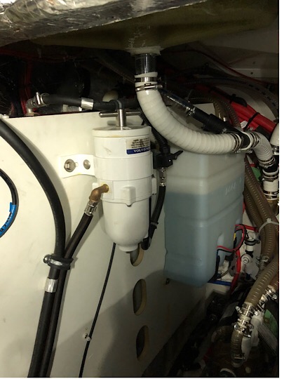

    I have a new boat that is powered by two VolvoPenta D6-370. The boat came with a pre-filter for each engine, the pre-filter is branded "Volvo" and it is identical to a "White Racor 500". The pre-filter has a Racor 10 micron filter in it and the filter that is built-in the engine is a 2 micron filter. I dislike the fact that the pre-filter is made of metal, I would like a transparent bowl to visually monitor the fuel and water (if any).
    I contacted a Racor supplier to replace the metal part by a transparent bowl. The per unit cost of upgrading the filter to transparent bowl is approximately $50 less than purchasing a new unit that costs a bit more than $200.
    I have seen comments on other threads here recommending other brands filters and also other Racor models. I verified that the fuel consumption of a D6-370 is well within the limits of the Racor 500, hence do not see any reason to install a bigger Racor model (right?).
    Before going ahead with this purchase, I would appreciate any comments or recommendation you might have. Please forgive me if this new thread is a duplicative, I couldn't find another thread completely covering my case.

    I am trying to respond to all questions raised:
    1) The boat is new, I purchased without hiring a surveyor,
    2) The filters I am considering to change are Volvo parts. They were installed by the manufacturer. The filter is approved for marine use,
    3) The upgrade cost to clear bowl includes the metal guard.

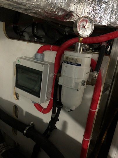

    4) I am attaching two pictures showing the filters. They are held up on a board that hides the fuel tanks. One filter has a vacuum gauge, I installed it to figure out if I like it.

    I like the on engine set-up as is. The metal canister makes sense being so close to the engine heat.
    What about a 20 micron MA500 closer to the fuel tank in an easy to see location for a first line defense of water contamination, etc. ?

    The two units you can see are mounted on a wooden board. Behind the board are the tanks. Each unit has a 10 micron filter. Despite being branded Volvo, they appear to be Racor 500 units.

    An advantage of going to a larger racor (900/1000) would be a lot more surface media to clog up before having to change filter elements. If you want the see through bowl, go for it as long as it has the metal guard underneath. For $50 extra, I'd just buy the entire racor assembly and either save the Volvo's for spares or sell them.

    Is that a battery cable wrapped around the filter in the second pic?

    This is electrical tubing into a explosion proof breaker panel. The breaker panel is for the generator.

    To ensure the protection of you, your ship, your investment; I'd ask your insurance company for their lead local surveyor and have him advise.
    The boat mfg may have just inventoried one style of filter. Volvo may of had a package for the boat mfg that included that filter.
    Or, some code some where was satisfied with the metal bowls that the DIYr may not understand.
    In the back of my mind, I remember reading (CFRs, ABYC) the concern with fuel filters, fittings and valves installed above or near batteries and switches.

    It is still up to the owner to best protect his investment and himself. That electrical cable and box, even though enclosed, still has me concerned.
    My advice is to get a surveyor that can quote the rules for your boat and intended use, that would hold up as best attempt to satisfy any claim.
    It may be nothing, it may be something. For liability reasons I'm not going to tell you it's o k.

    I had the same reaction about the cable and the breaker box so close to the filter. Probably ok by looks sloppy

    Actually that box doesn't look like an explosion proof box it looks like plastic and the fittings are definitely not explosion proof.
    Just sayin.

    I see the comments on the electrical panel, despite looking strange this is how the factory built (I bought the boat new). Perhaps another way to look at this is being reminded that sparks are not allowed in the engine room due to vapors. The location should matter less than having a zero spark risk (explosion proof installation).
    I do not see a need to hire a surveyor to verify the boat design. This boat has been certified in Europe and in US as is. But if based on your views, the clear bowl is not a good choice, I will end up adding a water sensor to the pre-filters.

    I think the better term for that box is ignition proof. No such thing but ignition resistant would be a better wording.
    If the bowl will accept a WIF (water in fuel) sensor, At least go there.
