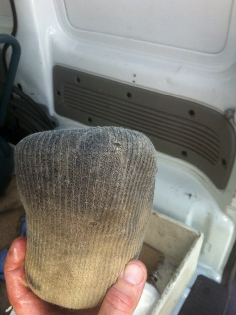

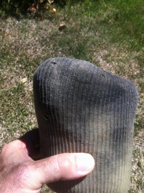

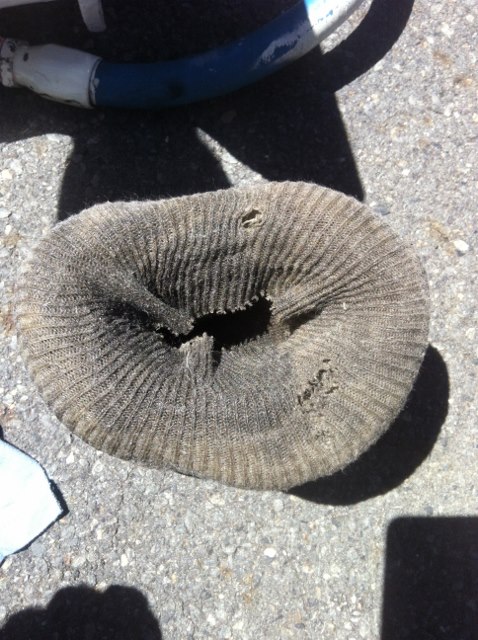

    The ONLY major item damaged is the oil filter for the gearbox. When the filter casing was opened, the mechanic had to work very hard to remove the filter from the casing. The filter had been sucked deeply into the hose opening that leads to the control block. See the images. Unfortunately, this seems to be a symptom, not a cause for the loss of oil pressure. Seems the filter was starved of oil & was sucked into the hose. This was a new filter 20 hours ago!

    My thoughts. The filter will not be sucked down if there is no oil, because air is easier to suck or pump that oil to begin with. This leads me to believe there is either a restriction prior to the oil filter (possibly the screen being blocked with debris). It could be a defective oil filter that was weak and crushed down and blocked flow, judging by the looks of it. Are you 100% certain that is the proper oil filter insert, try a different brand as well? Is there a way to convert it to a spin on oil filter and ditch the oil sock filter entirely? OR, check the vent and make sure it is free and clear. If the vent is blocked it may not allow the oil pump to pump oil from the pan and distribute it through the gear. The vent could easily be overlooked during a rebuild, if it has one.
  3. Capt Ralph
    13,439
    Checked the filter in the 3 bolt flange fitting & found a small amount of clutch material but a lot of lint type material.
    You found your cause. I'm sure the coarse filter screen was covered in lint or a passage restricted. Your filter was falling apart.
    Hint#2; Unless it's clogged, filter media should not move anywhere or deform.
    I never liked soc filters. Please try a standard, caged paper filter.

    I have a STRONG feeling the WRONG OIL FILTER was installed,

    How does the failed one look compared to the one in the other side?

    The day before, the mechanic was blaming the last mechanic or me for installing the wrong filter until I proved to him that the filter was installed by his team. then he said either type was acceptable. The filter in the other gearbox is in a cartridge!

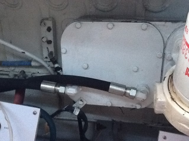

    I am unable to transfer a PDF pic to upload. Can you upload a picture of your clutch / block oil cooler?

    Here is the gear oil cooler:

    If that cooler fails it could definately blow the gear oil into the crankcase. I believe the cooler has a series of coils that the gear oil runs through, and the engine oil passes through that area to cool it off......To test it, remove both high pressure hoses, cap one of the cooler ends, get a brass fitting (cap), drill it and mount a shrader valve in it and pressurize it to 30 psi and see what happens......

    That oil cooler has two isolated cores. I'm pretty sure oil can NOT transfer between them. With no oil in the coolant, the leak is not here. Backward blow some low pressure air thru it to insure no restriction a is clear of lint.
