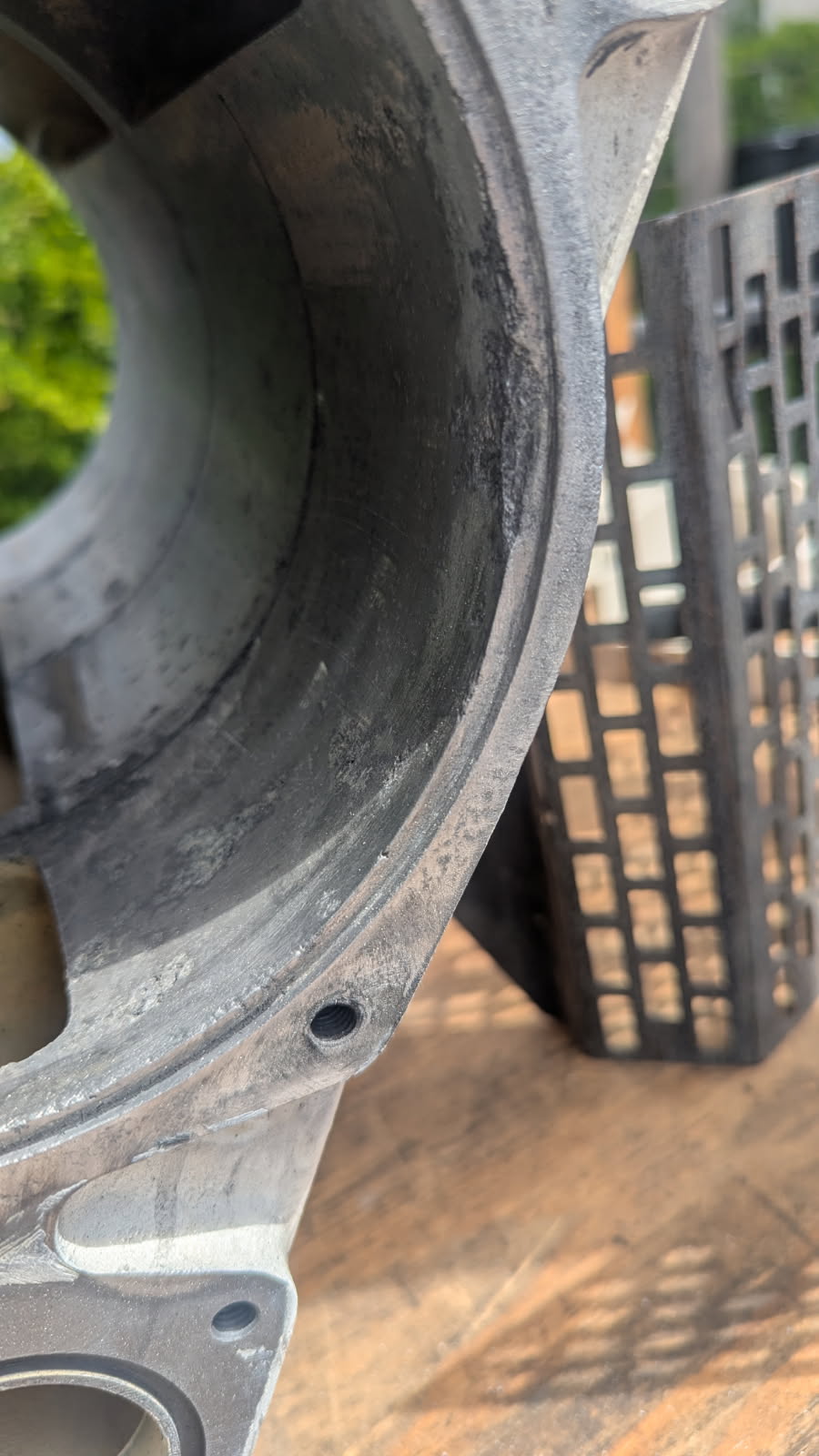

    Servicing the raw water system on my Volvo TAMD 74p’s, I found damage/corrosion to the sealing surface of the heat exchanger housing. This has been leaking raw water at pressure and I’m worried it’s only a matter of time until it gets into my coolant if I don’t repair it.
    It seems impossible to buy a new housing - can only buy the full assembly with bundle, etc for $11,000!!!
    Does anyone know if this should be repairable via some sort of weld or braze? I’m not even sure what the material is.

    I recall an O ring gasket.
    Do not take any heat to that alloy. Soldering in a bead will probably destroy the casting.
    Buba on the other side of the swamp would probably just use a better RTV.
    I would prefer something more rigid;
    Salt water side prevents the use of JB weld.
    A few drops of a better epoxy with surfacing thickener. Then shaping the surface with a home made sanding tool to re-make a flat O ring surface.
    Then RTV while assembling.

    I did this on a Series 60 charge air cooler a few years ago. So far it’s working
