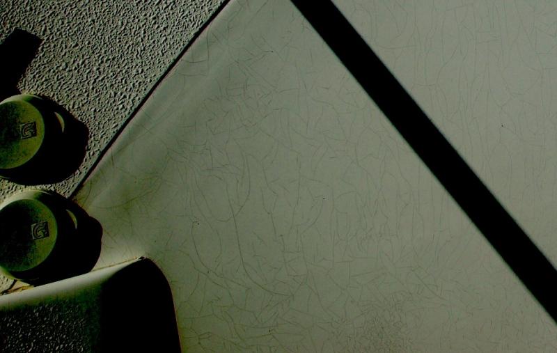

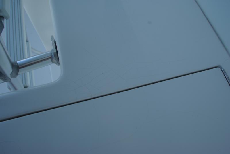

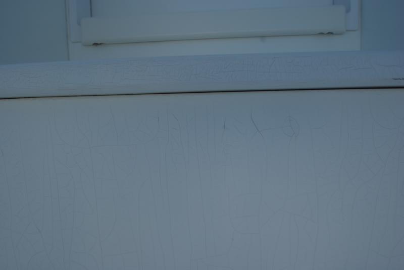

    Here are a few photos. The one with the messed up color has been upped in contrast to make the cracks come out in the digital photo, always looks better in pictures, but that shows the extent of the cracking on the foredeck.

    Wow, this gives us an impression of the gel coat issue. On my 46ft Post , I had on the entire fore and side deck in total about the same amount of cracks as you first picture, but not even that bad, you could hardly see them.
    We grinded it down to the fiberglass, filled it with 3M marine filler, sanded it and painted it with Epifanes anti skid paint.

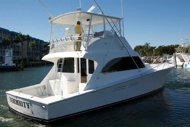

    As requested, a shot of the boat from the other day. Got a very aggressive price on redoing the boat, hopefully I can make the numbers work!
