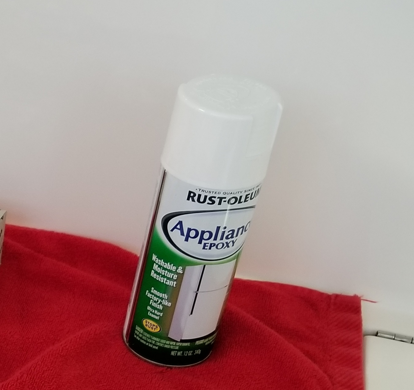

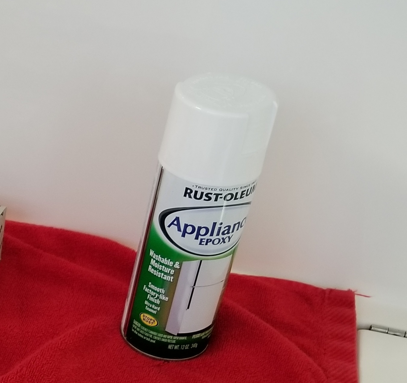

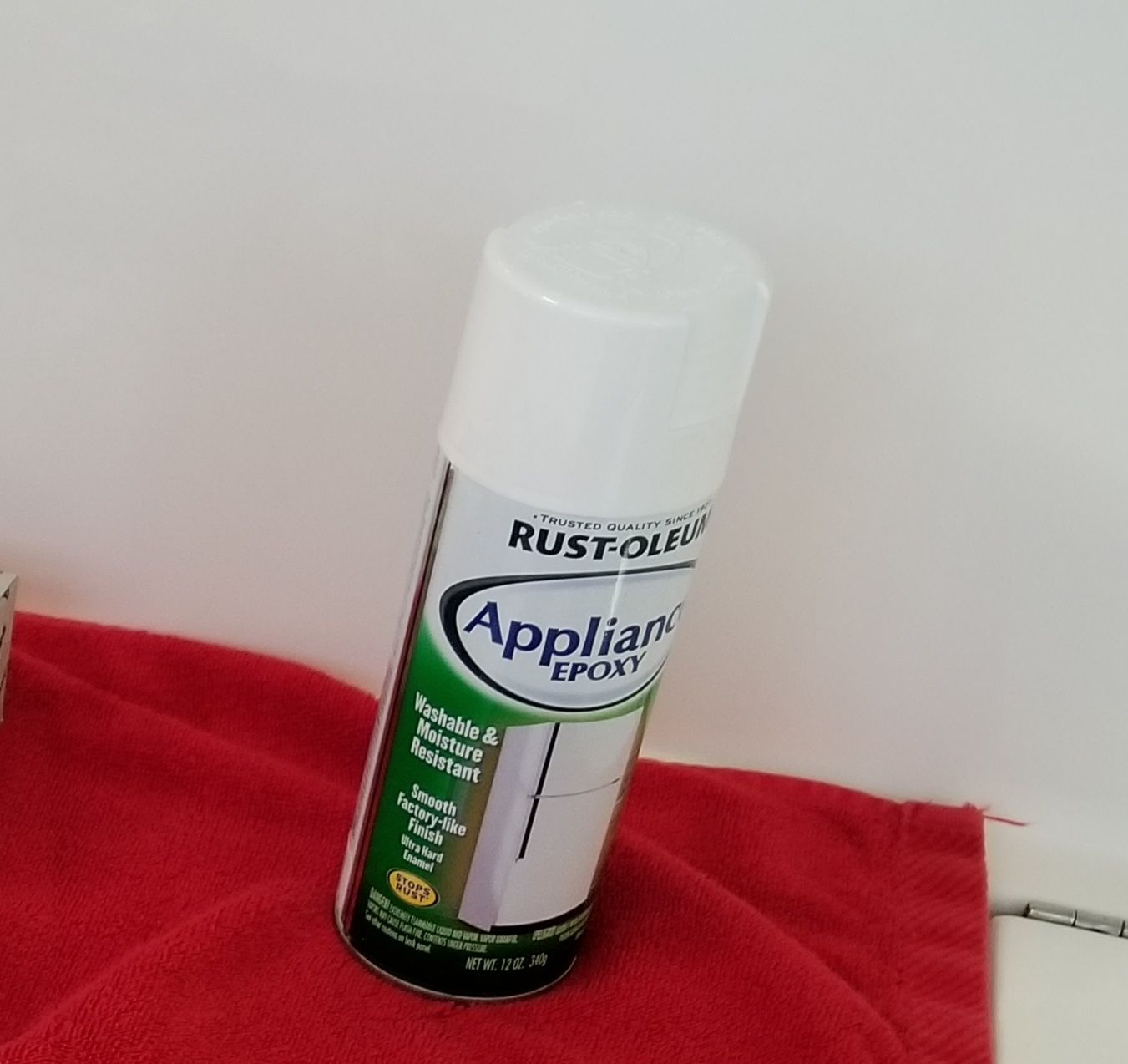

    This is what I use as recommended to me by my MAN dealer. Been very happy with it thus far on touch ups and keeping engines looking fresh.

  20. NYCAP123
    11,208
    I like Rust-oleum products, but I'm not sure that's the best product for this application. "
    Product description
    Color:Limited edition
    Rust-Oleum Specialty Appliance Epoxy is an ultra-hard, moisture resistance enamel that is specifically formulated for indoor metal surfaces. It provides a smooth, washable surface for refinishing the exterior of appliances such as refrigerators, dishwashers, laundry machines, and other indoor metal applications (cabinets, tables). Do not use on objects exposed to heat (stovetops, oven interiors, etc)
