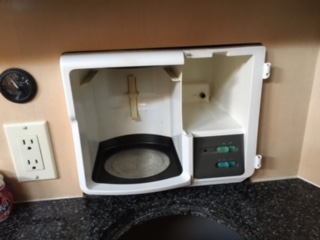

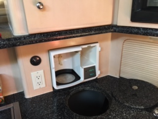

    OK,
    I'm loosing my mind.
    The original coffee maker on my 1999 Carver 404 is only working intermittently, so I was going to pull the unit and either repair it or replace it.
    The issue is that I can't remove the coffee maker from the cabinet. It looks like the boat was built around the coffee maker. I can't gain access to either side of the unit, nor from the top or bottom. There is no access behind the unit either.
    Am I missing something???
    I am at the point of breaking out a saw and taking the thing out in pieces.
    Does anyone have experience removing these??

    I believe that the coffee maker actually slides into a mounted bracket. Just left up a little maybe 1/8 of inch and pull it out, then you can remove the bracket that is holding it in there. Google built in coffee makers by Black and Decker, that is who made it.

    I will give this a shot on Monday when I get back to the vessel. There is not a lot of room to lift the machine, but I will give it a shot
    I know it sounds crazy But the counter below and above are both solid countertops (there is a small rat hole on the bottom for electrical wiring, but you couldn't fit your hand through the hole), the port side is a breadbox with a solid wall with no access panel, the starboard side is solid with no access panel and the aft is where the couch sits in the salon, and there is no access panel there either. I might be able to pull out the electrical outlet and access it through that opening, But it seems a little crazy to have to do that.
    I was looking at this last year when I thought I had to replace the water gauge (fortunately it was the holding tank sender unit that was bad), It is the strangest thing.
    Hopefully gbarger will be correct and the unit will lift up and out.
    Thanks for your input guys.
    Anyone else dealt with the removal of this coffee unit???

    I found the instructions on removing it.
    REMOVING THE COFFEEMAKER UNIT 1. To remove the unit from its mounting (for service or cleaning), first remove the Carafe. Slide your hand under the Coffeemaker to support the unit. Push up at the bottom rear to release the unit and slide it forward on its Track Guides. 2. To replace the unit in its mounting, slide the Coffeemaker along its Track Guides all the way back until it locks into place.
    What I did since you can't get under it, was reach to the back in the space where the pot goes and lift up from the rear inside, then while lifting, slide it out.
    I am attaching a PDF file with instructions.

    Perfect solution.
    The coffee maker popped right out after lifting up the rear of the unit.
    No need for the sawzall this time!!!
    Thank you everyone for your assistance.
