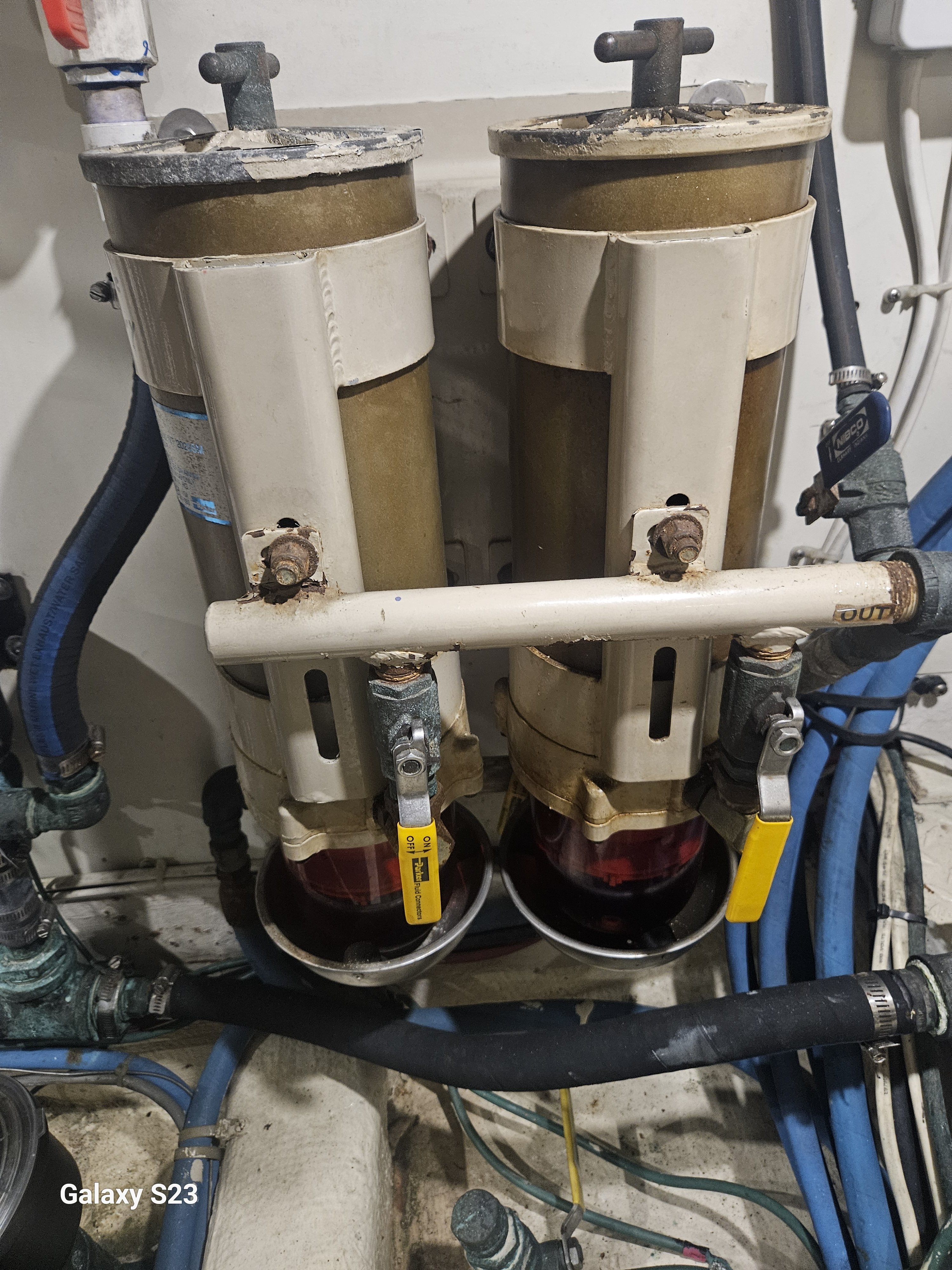

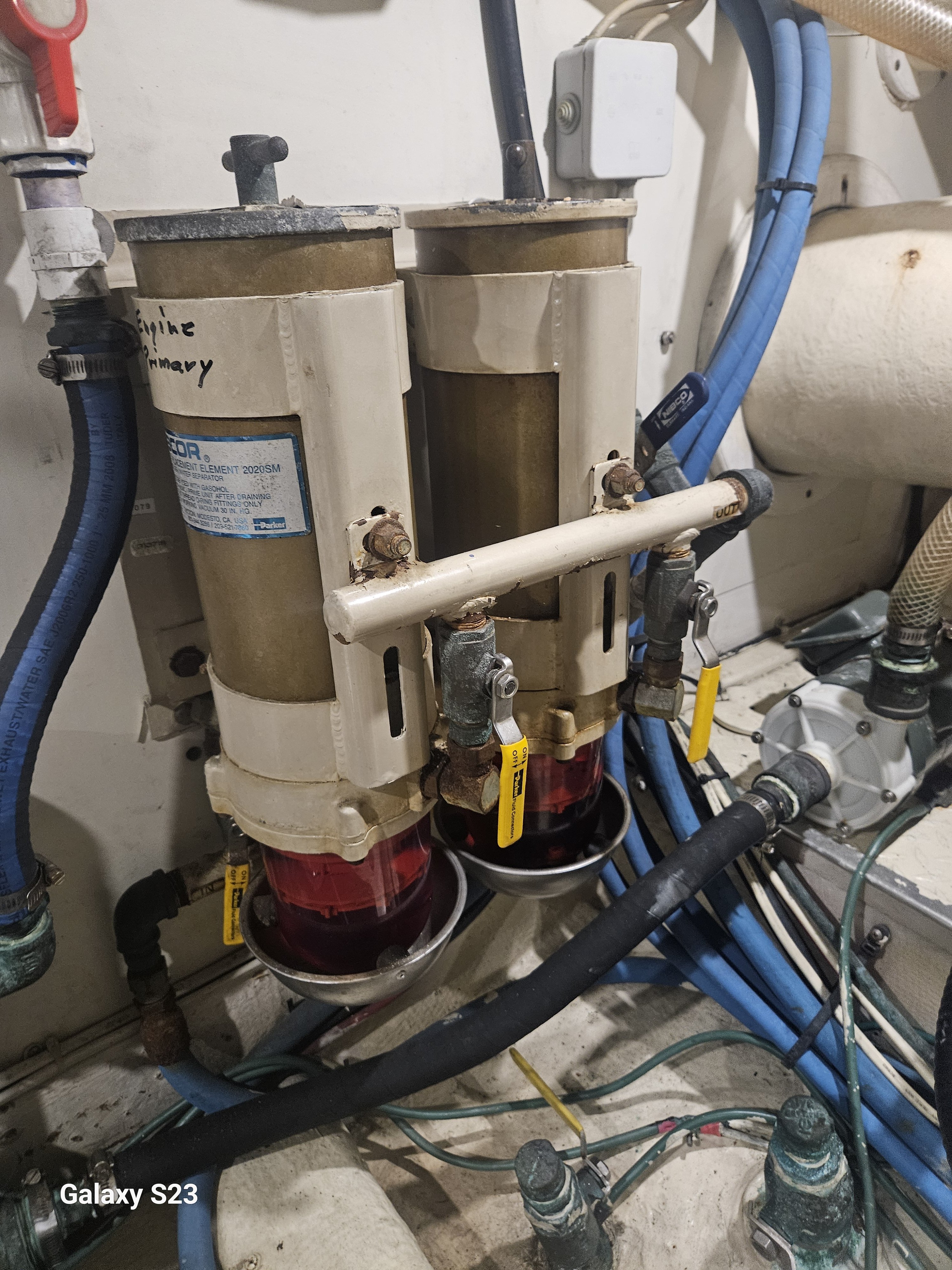

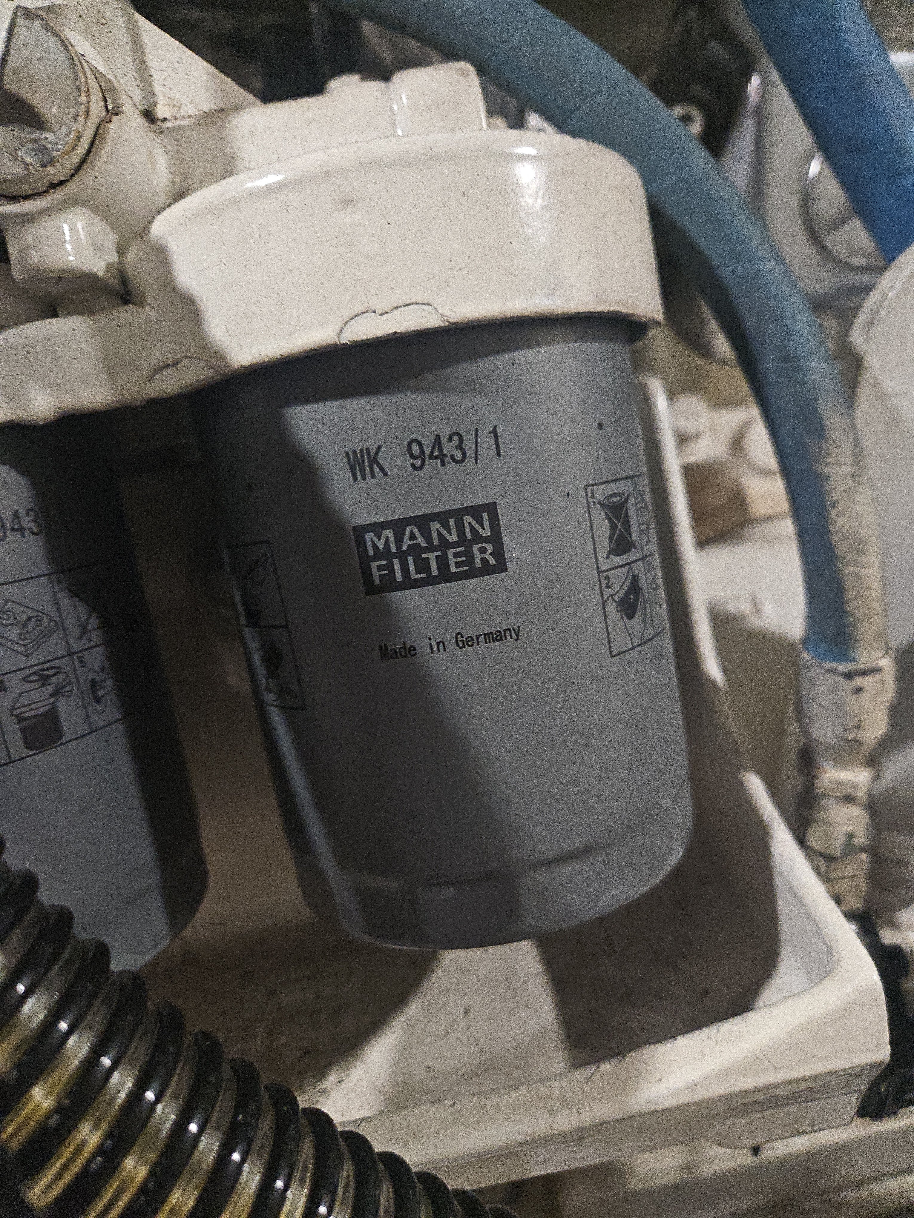

    Hi.
    I am looking at my current fuel system and it appears to be setup as two separate filters. Not running in series.
    So i can't step the filters down like. 30 micron to 10 micron.
    Am I missing something.
    Thanks Bryan

    Typically you run 30 on the Racors and 10 on the engine primary. The Racor setup seems to be standard allowing you to address an issue without losing prime.
  3. Pascal
    8,777
    Twin filters are set up so the filters are identical. The purpose is to be able to switch on the fly should you have a problem. Unless of course you run them both at the same time like some people do…
    i ve always run 30s in the Racors, and whatever secondary the manufacturer supplies, usually 2 microns.

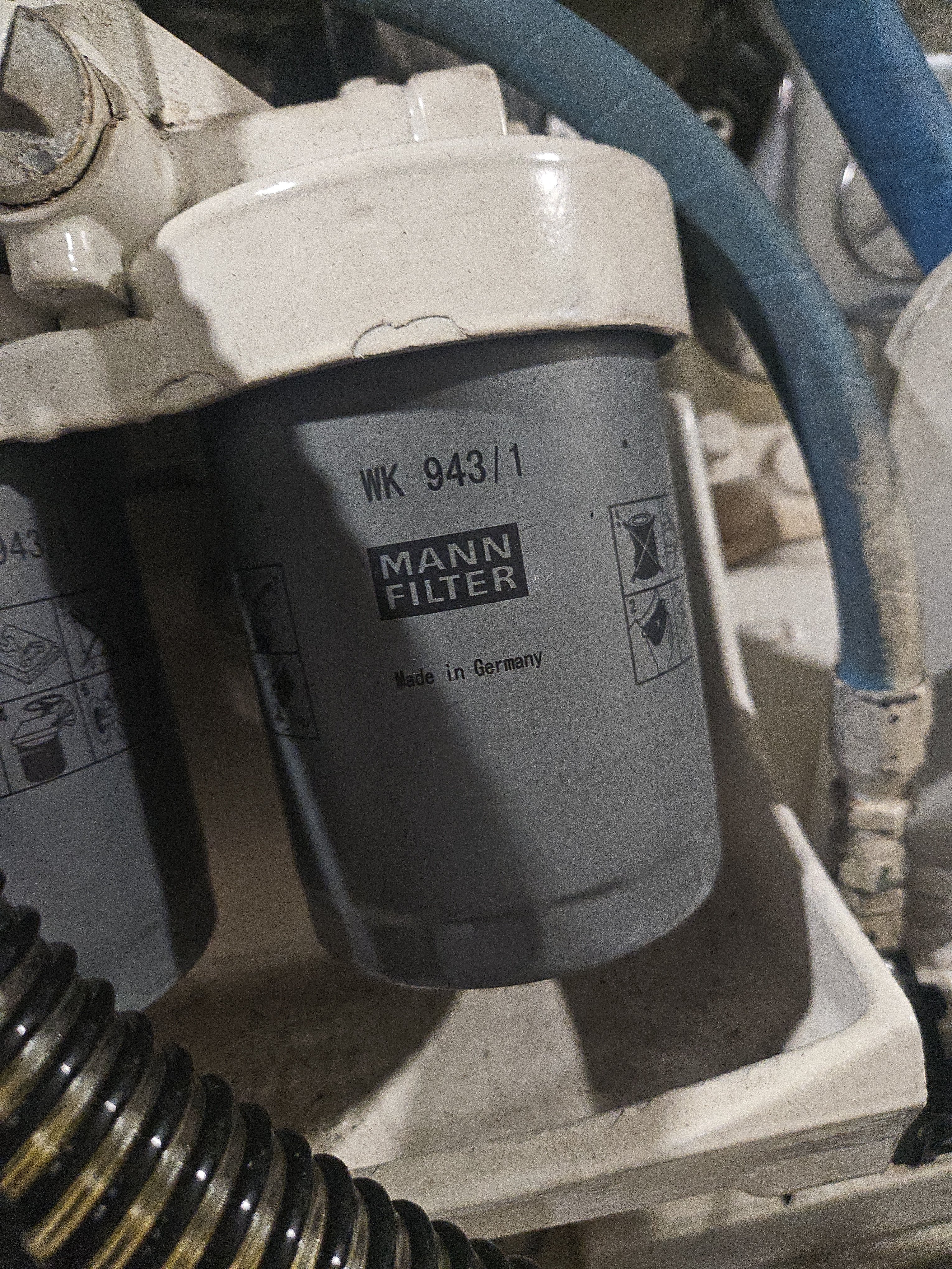

    Look back on your engines, at least one secondary filter should be mounted. If not we need to get you properly fixed.

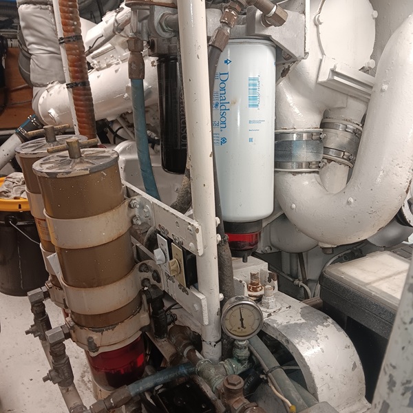

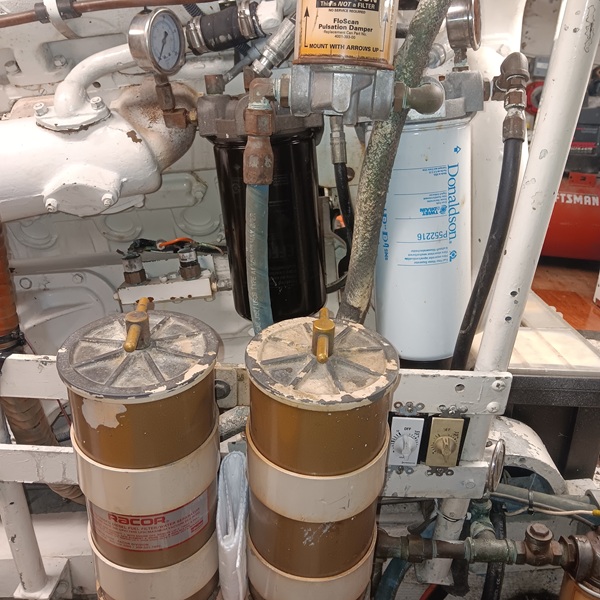

    When you want full fuel flow to your engine reliably, you filter your fuel in stages.
    I came up with three stages; Course, medium and fine. Vacuum and pressure gauges on the system also.
    I have the same older parallel Racors you have, as my dual mud filters @ 30mic. These alone have save many headaches using one at a time after bunkering ship fuel.
    Next filter with a sight bowl also @ 17mic and final filter @ 8mic.
    Later Racor filters may pass water (no more real fish oil used anymore) so I like the middle filter with another sight glass.
    If I was to just use Racor 10 or 2 mic filters like others state they do, I would be still drifting offshore today and out of filters.
    Every deployment, I carry eight or more 30m Racors and two of each of the other fuel filters.
    Dual gen-sets draw from a single Racor 30m then to each owns 10m secondary.
    Gen-set pick-up tubes do not go so far down into the fuel tanks. Don't pick up all that bottom junk & water.

    Hi. Thanks for all the information, helps clarify the system. I do have dual low micron filters on the motor.
    I have been running with both Racor filters open. Now I think I will run one at a time. That way I have a fresh backup. 71c1dbcd-e18a-49e2-bf99-32bb6e1a825b.jpg
