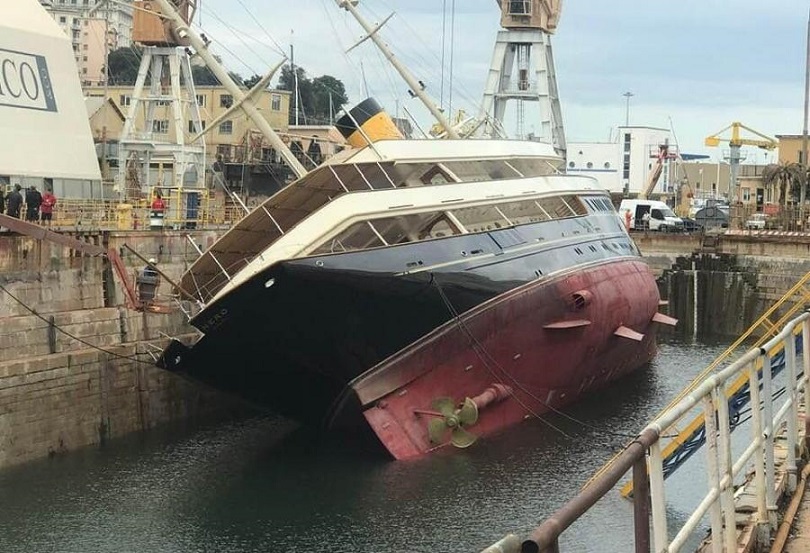

  9. Yacht News
    26,890
    Won't be the first time a yacht tipped over in dry dock. Off the top of my head...the last major one was the 90-meter "Nero".
