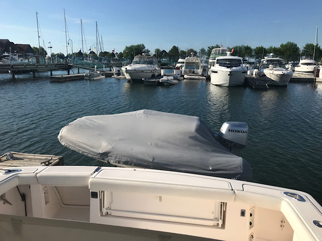

    Depending on the boat it’s going on, weight will be as big of an issue as size. When we first installed the freedom lift, I tried a friend’s zodiac 340 that weighed close to 900 lbs. it made the boat a little tender in a beam sea, especially at slow speeds. We opted for the Walker Bay Generation 11 LTE (just order 600lbs wet) and love it. AFB747BF-2161-4245-ADD6-8E238C7839B1.jpeg
