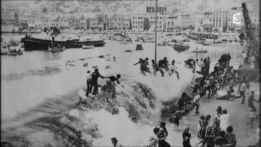

    Launch.jpg Float out launches also reduce spectator participation. This is the launch of a ship in La Ciotat. There is a great video of the event someplace, I saw it in the shipyard museum but cannot find it online ... it is an amazing few moments of suspense and hilarity.
    This is from the Musee Ciotaden
