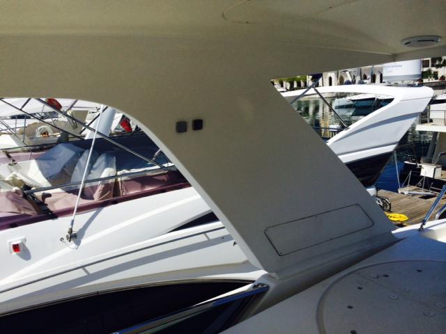

    From the distance it looks good....

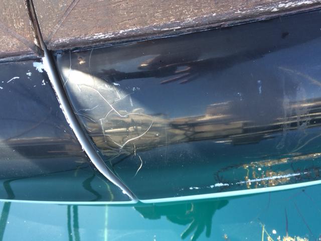

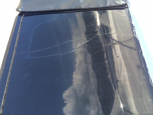

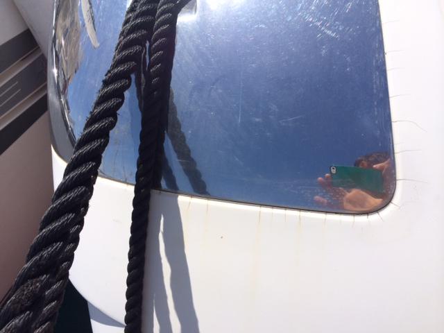

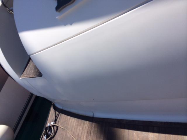

  3. RUSSLAND
    RUSSLAND Member
    Nov 25, 2009
    32
    Italy
    The boat is 2010. The gelcoat cracks are everywhere. Cost Euro 2M+ back then in 2010 when the contract was signed.

    The stress cracks shown beneath the teak strip appear to be from impact, meaning the underlying laminate could be sacrificed. If you have gelcoat cracks in areas not exposed to impact, they are probable signs of structural flexing.
