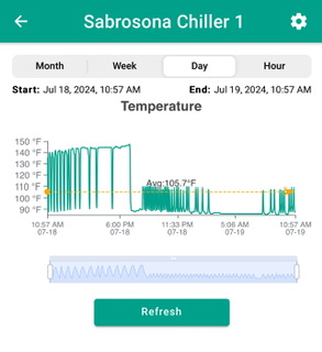

    With air temp in the low 90s, water temp not too far behind and heat index over 100 air cons
    are working hard here in sofl. Over the last few weeks I noticed my coil temps creeping up along with amps. I can keep an eye on the panel digital multimeters from the salon and the 240v air con side of the panel (two 36k chillers and 2 pumps) had been creeping to 39 / 40 amps. Not much left from a single 50 amp cord.
    Occasional back flush helped but not enough. Last descale was about 9 months ago.
    So yesterday I descaled the coils with Barnacle buster. I have a 5 gallon bucket with a mounted 1800 rule 120v and hoses all set up. An hour each chiller, one at a time so the boat would remain cool. This resulted not only in a 30 degree drop in coil temp but each chiller power use dropped from 19 amps to 13. Big difference for the electrical system.

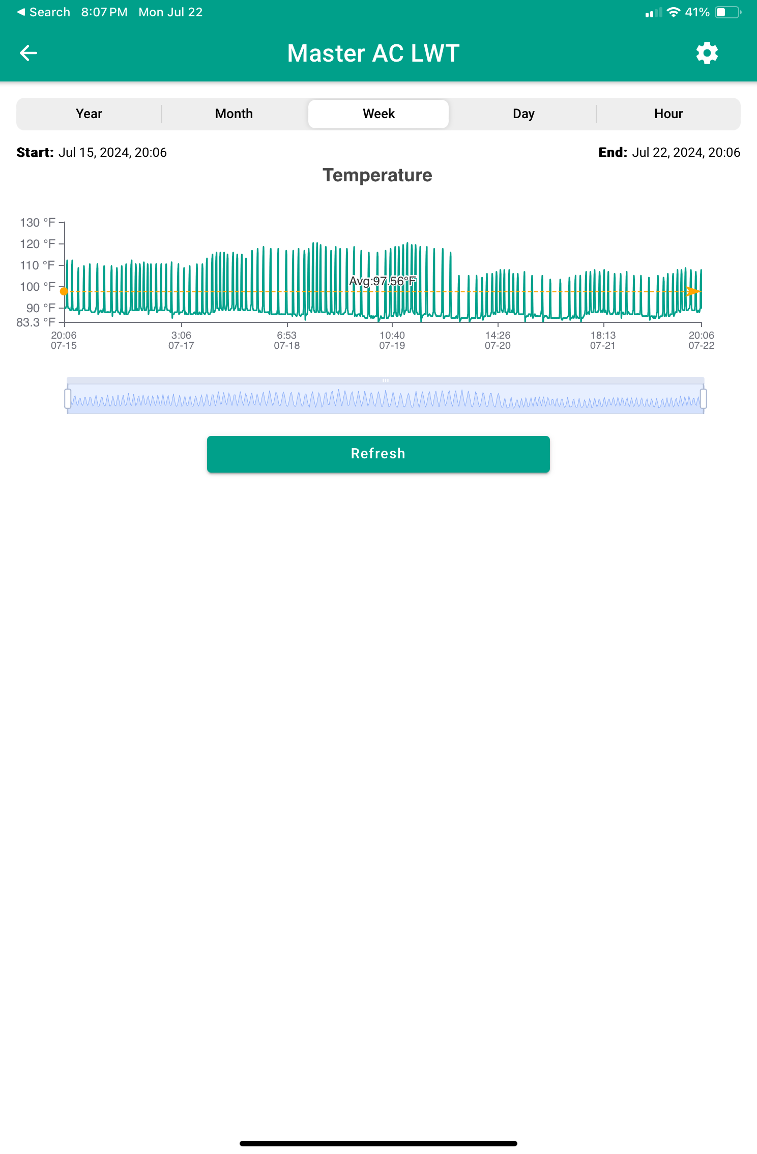

    A little thread drift. Wanted to say a huge thank you for posting about the MOCREO cloud solution. We owned a Riviera 60. Loved the boat but had some AC cooling issues. Spec’d/built a Riviera 64SMY and let them know I would have high expectations for cooling system.
    As soon as we took delivery I put water temp sensors on all 7 condensing units as well as temp/humidity sensors throughout the boat and in refrigeration units as well.
    With all the data I could see I had some significant AC water flow issues. “Unfortunately” nothing was tripping so I suspected it would take some work to get Riviera to dive into. But dive they did, invested in some mods and I have a much better system now. Data was a huge help.
    We have an Electrosea unit and, fingers crossed, data doesn’t show growth/fouling. Last week two units leaving water temps jumped by 7-10 degrees at the same exact time . They are on a water branch with another unit that didn’t change. Just yesterday one of the units dropped back down, even lower than the norm. The other is still high. I’m guessing some type of obstruction (clot like) is moving around.

    Pascal, where’d you locate the sensor probes? Against the discharge point of the heat exchangers??
  12. Pascal
    8,474
    I have one on each coil, at the top of the coil in the middle, held with a zip tie.
    the accuracy of the reading isn’t as important as the trend

  14. Pascal
    8,474
    I checked with an ir gun and that was pretty much the hottest spot.
    I also have a sensor on the chilled loop as well as on things like hydraulic circuits, fridges and freezers and even the eFoil lithium battery
