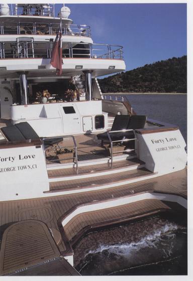

  7. Crewagency
    Crewagency Guest
    Marine deck 2000
    I rembered that i read the Article in Boat International June 2003 that the 42m
    ( Sport Fisherman ) name Forty Love was equiped with a like Teak looking material that is called Marine Deck 2000. I searched in the net and found the link
    http://www.stazo.nl/html/exterior.html for some more info.
    Seems that this is a proved material and a alternative to teak ! ?
    Below the picture of the Aft. Deck
