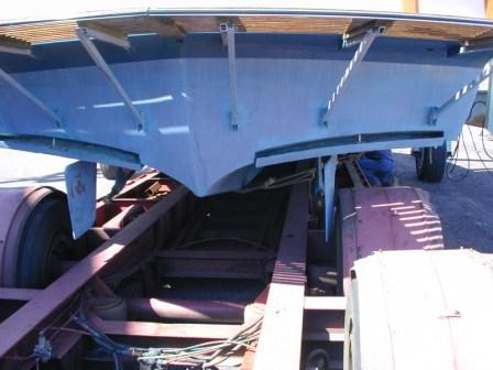

    I am preparing to load my 37 Rivera Express onto its new trailer.
    The literature I have indicates the Roamer is about 13' 6" tall (havent measured accurately yet, ran out of time today to cach my flight back home.
    I did a rough measure a while back and it seemed like 13-6 was a little on the high side.
    Also not sure and what the reference points are given about a 3'-6" draft and handrails on top of hardtop.
    I want to get a low as possible for trip frm Wisconsin to Calif so removal of some items
    - props for sure,
    - rudders ( 1'-7" from bottom of hull gets about about a net of 4"
    - propshaft struts are about 1'-3" from bottom of hull
    Q- any one have photos or explanation of rudder removal and propshaft strut removal and/or accurate measurements of 65 37 Rivera from keel to hardtop

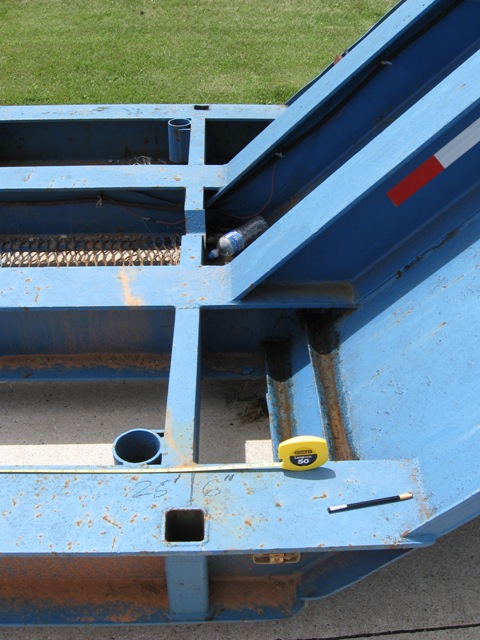

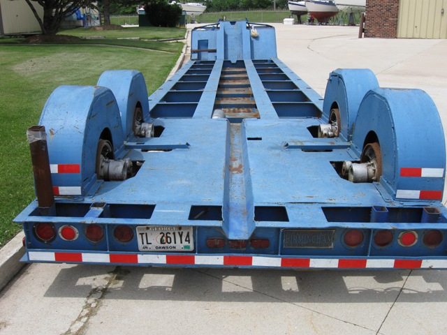

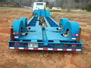

    Your commander looks like there is more curve to the bottom of the hull. The roamer is surprisingly flat. The props and rudder will fit in a void between two of the trailer beams. Beams are 8" x 10", open space between is about 1'-10", struts centerline about 2'3" from keel CL so ok on width.
    Issue is depth, beams are 10" as noted with about 8" of ground clearence, so with rudder dist tip to hull of 1'7" and strut dist of 1'3", using 2" above bottom of beam for protection from road debris puts it 11-12" above the deck w/ rudders left on and 7-8" with rudders off and only struts on, taking off struts gets the additional 7" or so.

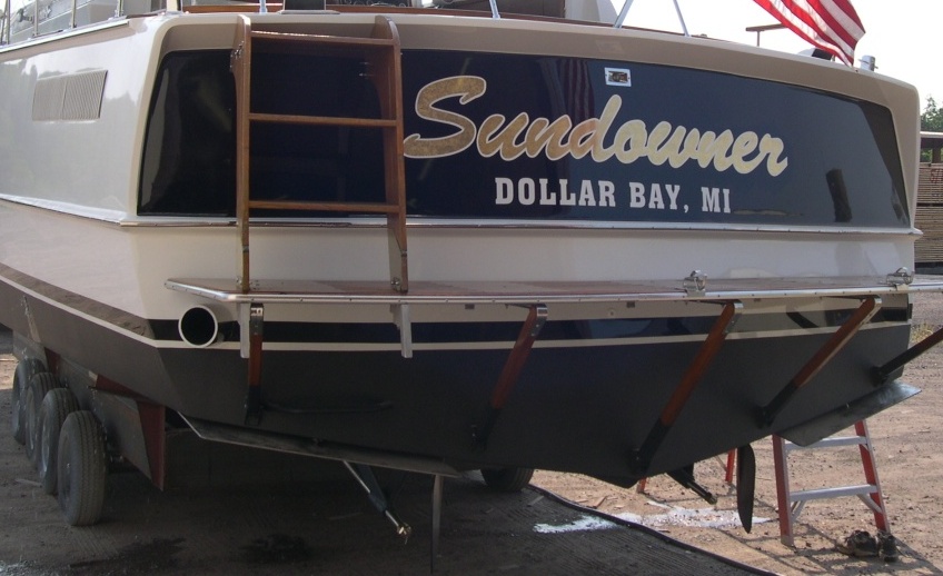

    While you can gain some room by removing the rudders if the strut setup is like our Regal, you will be gaining only a small distance. If you look closely on the attached pic taken when we converted to 1-3/4" shafts you will see the tip of the rudder which is only slightly lower than the strut to begin with. Hopefully your strut is on a steeper angle and as a result will allow you more to gain.
    Dropping our rudders wasn't that difficult, but ours turned freely to begin with and weren't overly worn or stuck as some have indicated on the forum.

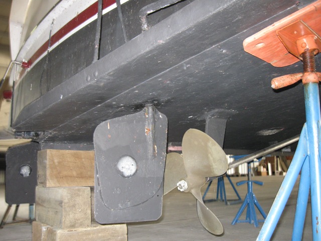

    I resized my images today. It looks like stuts on your and mine are welded which if so means they will stay in place.:cool:

    Our Roamer is indeed welded, and not bolted as your picture shows. Unless that was your Hat? Sure looked like a Roamer hull though.
    Just saw that the original poster of this thread has extra material welded on to his rudders so he does have some height to gain with the removal compared to ours.

  9. Hey Mark... not lurking; TESTING! Just wondering if anyone is paying attention. Look closely between the Vs and youll see the original pad/weldment from the OEM single aluminum strut. The pads satyed because of too much weld to grind out! Also built intermediate struts when I went from 283s to 454s.
    We just finishing sandblasting the bottom and primed 3X with coal tar epoxy then tri-lux AF. I think if its really an issue, I would trim that stuff off the rudders, but NOT cut the struts. ALIGNMENT issues will ensue! ws

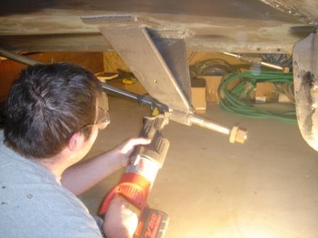

    Bill, I never even noticed the single pad until you mentioned it! As to your comment about cutting struts and the re-alignment issues later, you are dead on. When we cut the 1-1/2" tubes off of the struts and prepared to re-install the 1-3/4" tubes I made centering plugs for the shaft logs to hold the new strut cylinders into as close alignemt as was possible. Even with welding slowly and switching faces as often as we could we still struggled pushing the old shafts out. Once we installed the new composite cutlass bearings we found that the port engine was much more out of line than i had contemplated or allowed with the slots on the engine mounting plates. The starboard came out fine and as planned, but the Port was a pain. Goes to show that even with all sorts of planning to make it smooth, when you take apart the propulsion system and reweld parts of it, you can count on needing a major alignment again!
