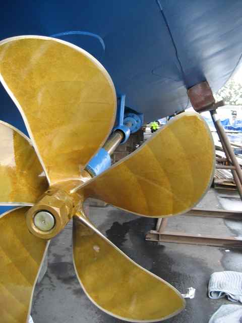

    You'd be surprised, but some scaling and a few barnacles can knock off 10% of your speed/efficiency pretty easily. Most people use a 2" wide s/s putty knife. Yards will typically spray acid on them and then wash it off......
    Propspeed or trilux works well at keeping barnacles and growth off.......You'll really need to prep the propellors if you decide to coat them with either.

    If you use Propspeed, consider this tip I learned from Marine Group Boatworks in San Diego. Mask the blade tip edges prior to applying prop speed. An uneven drip or coating on the edges can create a prop note or singing once underway.
