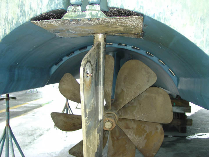

  7. YachtForums
    20,611
    When properly configured, that 'dirtier' water can be your friend...
