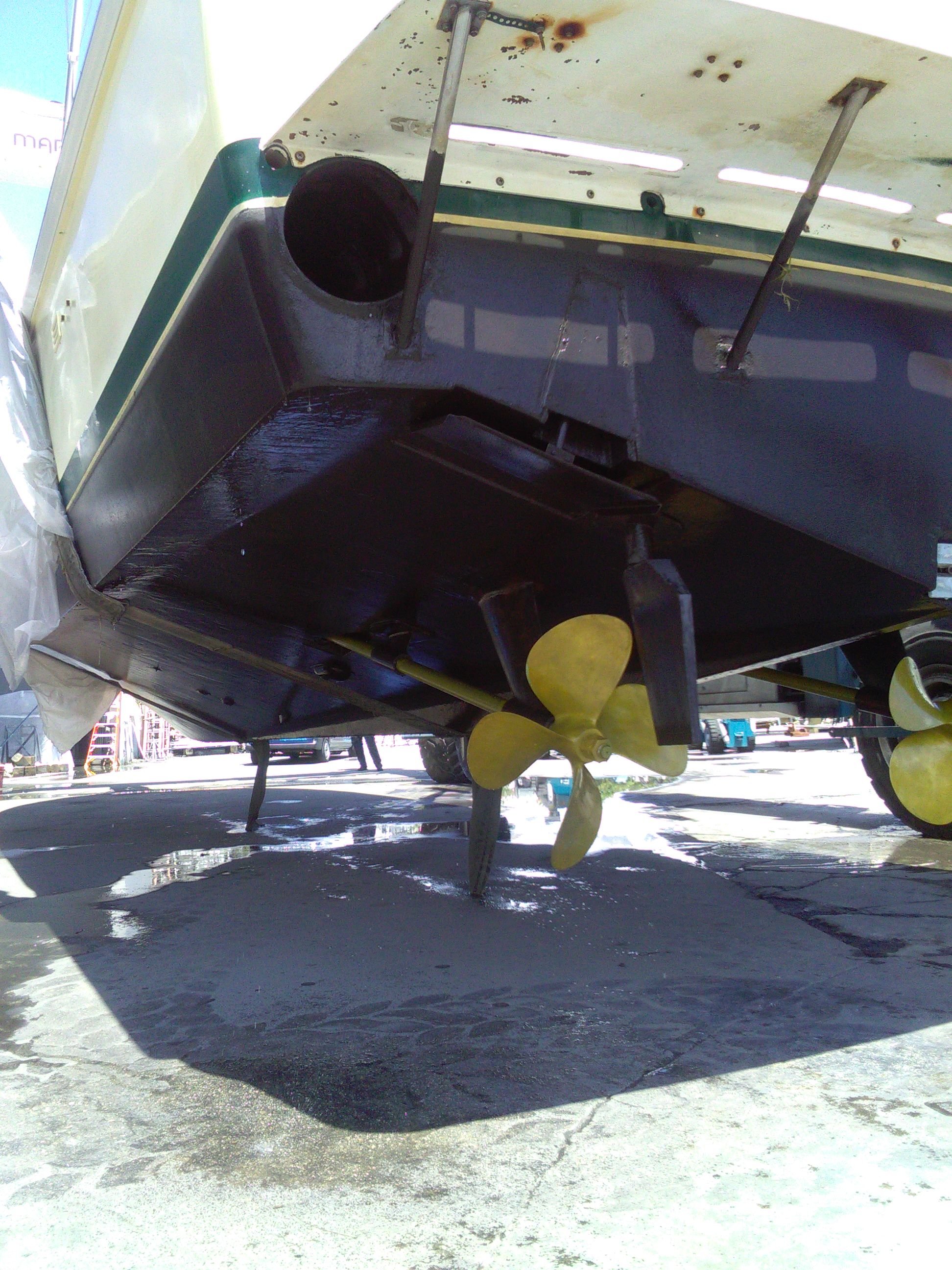

  1. SplashFl
    SplashFl Active Member
    Feb 2, 2021
    515
    S. Florida _ Bertram 46
    No spare props as of yet, and since she has optional engines I question the accuracy of stated pitch in the survey report. Bottom was painted last month by previous owner, including Propspeed so I'm not expecting to see any size markings. Short of removal and taking one to prop shop, anyone know how to measure the pitch as I'm fairly confident in the 31" diameter.

  5. mapism
    mapism Senior Member
    Aug 9, 2008
    2,166
    Sardinia
    Removal and measurement by a prop shop is the only accurate way to measure pitch, AFAIK.
    Never heard of the system Capt Fred mentioned, and while it doesn't sound very accurate to me, maybe it is - IDK.
    There's another thing that grabbed my attention in your photo, though: no anodes anywhere on the u/w gear (rudders/struts/shafts/props).
    I see the centerline anodes astern, which I assume are connected to the engines, as per MAN installation standards.
    But even if they were grounded together with all the u/w gear (which is not what MAN recommend, BTW), it's good practice to fit dedicated anodes anyway, to my knowledge.
    PS: diameter doesn't help at all in estimating pitch, but if you would post your max speed+rpm, and also the gearbox ratio, it would be possible to make a (very rough!) pitch estimate.

  10. Capt J
    14,521
  11. SplashFl
    Feb 2, 2021
    515
    Good eye but she's a 1996 Bertram with one owner until my recent purchase. Survey day included the Man mechanic, of over a decade, as well as both diesel and vessel surveyors. Nothing was found in need of attention relating to the single zinc, partially shown in the photo which sits within an "indented" area so nothing that might catch a line and cause loss of a fish, protrudes beyond the transom.

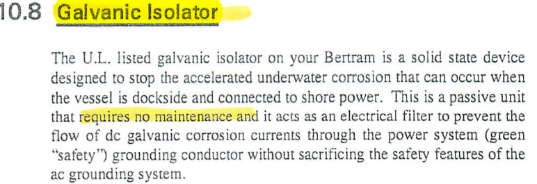

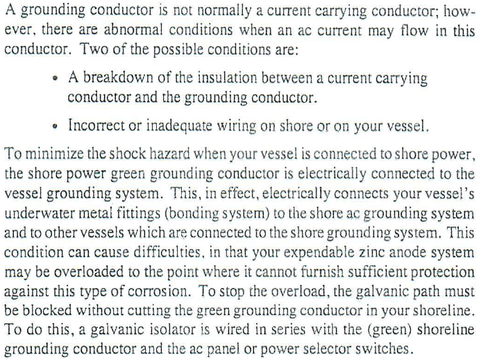

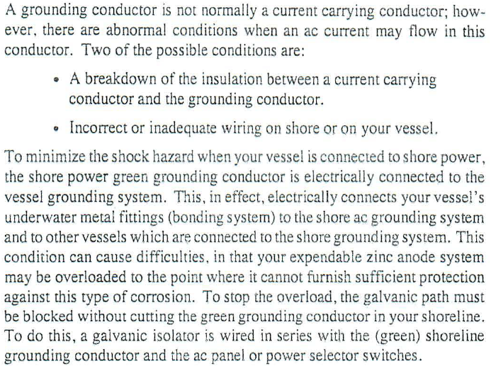

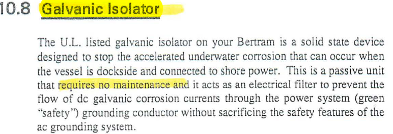

  17. SplashFl
    Feb 2, 2021
    515
    Obviously one of the many things to be aware of but at this point I've no reason to make any changes in new to me boat, since there were no signs of any electrolysis related damage since her 26 years ago build, and since I've also had a visit by a top name marine electric company who after running their tests installed a galvanic isolator in my prior Bertram after which the zincs stopped vanishing.
    To the contrary, last year I noticed divers changing props on another vessel about 100 ft. away and later learned electrolysis had made a meal of them.
    The Bertram Owners Manual states the following:
  18. Capt Ralph
    13,416
    Absolutely great to have an isolator on board. They do greatly reduce galvanic erosion in a marina environment.
    I'm not trying to talk you into anything. Just continuing that an extra zinc is not going to hurt anything as over zincing.
    Also, A good diver schedule is also a great PM tool.
