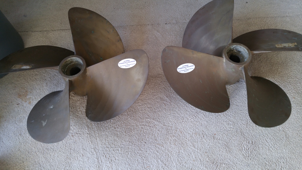

    I was curious to know if anybody could tell me how to decipher the information on these propellers my father-in-law picked-up yesterday? Any and all help would be appreciated!
    I can't seem to find anywhere online that explains what each number/measurement means. Could somebody break it down for me?
    Thank you ahead of time!

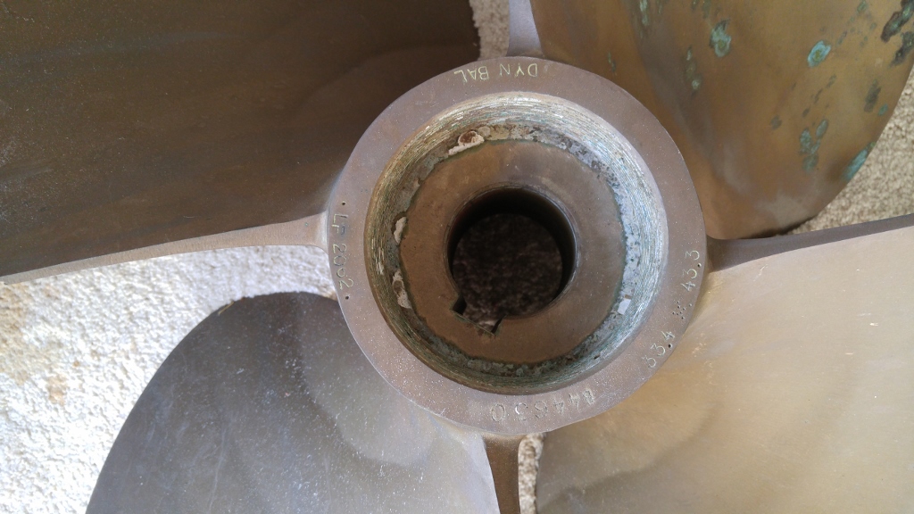

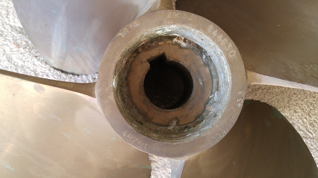

    33.4" diameter 43.3" pitch are the important numbers. Couldn't make out the prop shop label but looks like Bay Propeller, might try giving them a shout, that 48751 stamp is a prop shop ID and the six digit numbers are serial numbers. Look like a set of Michigan Dyna Quads but could also be Teinbridges.

    WoW! Thank you Bill! The only thing I knew for sure was the 33.4" diameter. I had a feeling the 43.3" was the pitch from online research. The shop is located in Stuart, FL called Blair Propeller & Marine Service. The main thing I am trying to learn is the metal (not to melt down, so you know). I have seen bronze mostly but, last night, I saw nibral. I have learned that nibral is better than bronze in that they are stronger and flex less. Is this true?
    I should be able to figure out if they are Michigans or Teignbridges, right?
    Lastly, overall, from what you can tell and know do you think these are good propellers?

    They're almost certainly NiBrAl. Michigan has changed their casting a lot of late and they don't look like the current version of the DQ's, Teinbridge is still a possibility but the blade shape and lack of apparent cupping could also indicate Veem but I've never seen that recessed hub configuration from them. Worth a call to Blair!

    Nibral is better than Bronze and do flex less and are stronger.
    The hub is stamped Dyn BAL- for dynamically balanced
    The LP number is probably for Lauderdale Propellor shop and their serial number. A call to them would probably get you any other info you need.
    They look like Michigans to me, but not sure.
