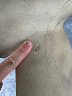

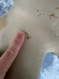

    Noticed pitting on the base of all four blades of our stbd wheel and one blade base of the port wheel all in the exact same location. About the size of a thumbnail a few millimeters deep.Looks like cavitation pitting or prop burn.l? Don't know exact age but the wheels are probably 15 years old. I'm trying to upload a photo they are to large from my phone

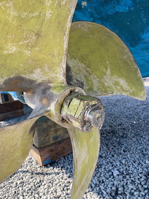

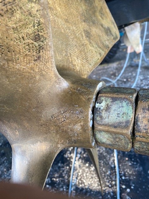

    I have attached a couple of photos of the 40 Cabo set up. One with Federal which is my boat and one with Veem. I ended up servicing my Federal EQY props during my last haul out, however I will be switching to Veem props in the future. The question is should I go with (4) or (5) blade Veems. I did not see any heavy pitting as you noted on your props from your 43 Cabo.
  6. Capt Maritime
    Capt Maritime Member
    Jun 16, 2022
    152
    Virginia Beach, VA
    Attached is a 45 Cabo express that switched to (5) blade Veems and experienced a substantial performance improvement. Veem quoted a 24X32X5 blade set up for my Cabo 40 with C12 CATs.

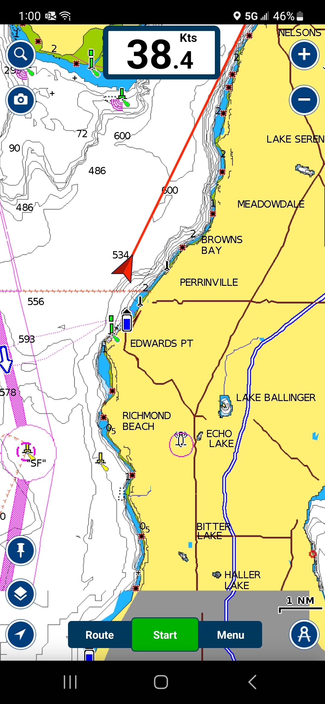

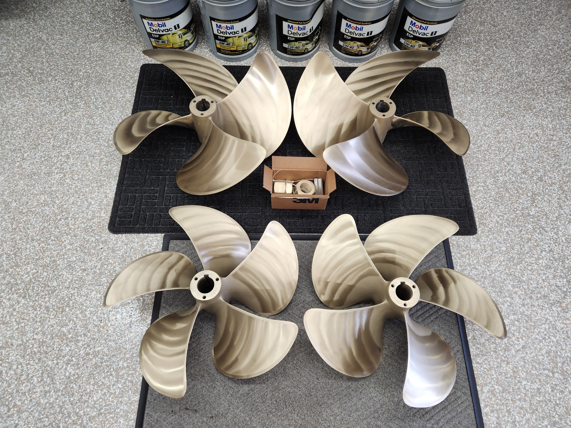

    Veems are fast and very good props. My 48 has a set of 5 blade Federals and 4 blade Veems. Last owner never ran the Veems as he liked the lift the 5 blade Federals provided. The 5 blades are very smooth and perform well are a few knots slower. I put the Veems on after yard visit this winter as I really liked how the Veems performed on my previous 40 Cabo. The Veems perform great on the 48 as well and are what I plan to run going fwd.
    Attached are the props side by side after cleanup and screenshot is from my phone on the way home. Electronics install underway now.

    The 38.4 Kts on the GPS screen shot, is that your 48 with the (4) blade Veems?
  10. CaboFly
    CaboFly Active Member
    Aug 24, 2018
    287
    Seattle
    Yes

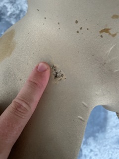

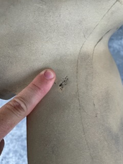

    00FFE1CB-BFD6-4AA4-8B1E-42C4A1F73A23.jpeg 3142541E-8AF3-4C03-948C-385C58A43C71.jpeg

    Above is the pitting I had fixed it was at the base of all 4 blades on stbd and 1 blade on the port
  13. Capt Ralph
    14,578
    Pretty common what?? Electrolysis, cavitation, old repair or mixed fill metal ??

    They've probably been repaired in the past, they're 18 yrs old

    Possibly we aren't within 500ft of other boats the bonding wires on the strut and shafts are intact. The pitting is in the exact same spot on base of each blade
  17. Capt Ralph
    14,578
    Could be filler or repair brass after original casting, getting ate away.
    From factory or past repair.
    Less noble metals (brass) can disappear in the environment with out the help from another boat.
    Your dock or river bottom can make galvanic current.
    Your own shaft SS shaft could be drawing from the prop.
    As how a prop works, electrical currents thru the water is still full of guesses and assumptions.
