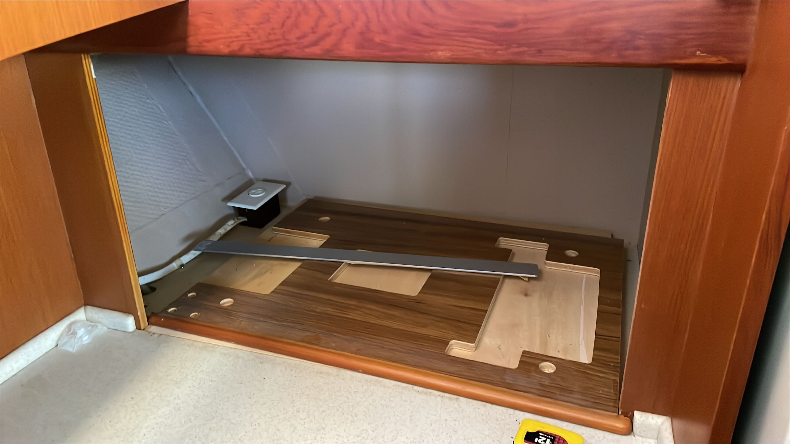

    The microwave in my new-to-me post 42 wouldn’t power up. Took me a while to figure out how to get it out and I figured I’d share a pic so others could see how it’s installed.
    The microwave is mounted on a piece of plywood with cut-outs for the feet. The plywood has a finished bottom trim piece mounted to it.
    The plywood mount is secured via a few screws that are accessed from underneath the countertop by removing the drawer underneath the microwave.
    So, to get the microwave out, you remove the screws securing the plywood mounting block to the counter. Then, slide the microwave and plywood piece out together. It’s a little tricky because it runs into the sink faucet eventually but it will lift out. There was also a metal bracket on top of the microwave that was secured by some fasteners coming down from the cabinet top above the microwave. It’s unclear how/if this was doing anything because i unscrewed it before I could see.
    The microwave issue turned out to be a blown ceramic fuse. It does appear sharp still makes a microwave/convection combo with matching dimensions for ~$500 but fortunately it looks like the fuse will get me back in business. Hope this is helpful to someone else down the line. IMG_1632.jpeg

    I owned a 42 Post and during my refit I was often impressed by how clever the Post kids were with their installs - among other things. IIRC the TV had a similar launch pad.
