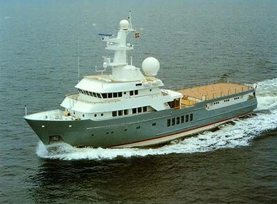

  4. KCook
    KCook Senior Member
    Jun 24, 2005
    1,160
    Phoenix
    The Portuguese bridge borders on being a legal requirement for expedition yachts and trawlers ;) .
    [​IMG]
    This one is unusually spacious. Typically they are not so deep, front-to-back. May or may not also feature a passageway on the centerline down to the foredeck.
    Any boat big enough for a Portuguese bridge would be big enough for me! :D :D
    Kelly Cook

    A Portuguese bridge is a structural component frequently seen on trawlers because trawlers are typically (or more precisely "should be") built for being able to handle heavy seas. The purpose of the bridge is to deflect green water from the foredeck up over the superstructure top rather than slamming against the forward windows of the pilothouse. A secondary benefit is that it provides a "safe area" or handhold when it is necessary to be on the foredeck in inclement weather. And lastly, it provides additional storage space for lines, fire extinguisher, spare anchor, drogue, etc. if the builder has provided access doors and lockers on the inside of the bridge.

    I have never seen a Portugese Bridge arrangement where one could work on the foredeck and hang onto the rail around the outside of the bridge.
    Do you have any pictures of this type of arrangement that you could share with us?
