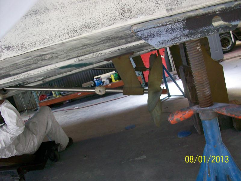

    Are These Zincs Too Close To The Cutlass & Strutt?
    Are they going to stop flow to the cutlass B?
    They put the new ones right where these old ones were...

    Does that mean the shaft is slightly "egged", or slightly bent? Just curious. If the shaft is bent, that will cause more wear on the cutlas.
    As to position, I usually install my zincs closer to the hull. BTW, is that an old zinc pictured?

    That's a big egg. The cutlass should get plenty of water but I can imagine some turbulence hitting the wheel. Maybe some sound or what could feel like vibration.
    You have to remember, running gear, propellers, shafts and zincs are Not an exact science. It may still take trial and error in these modern times.

    Yes, these are the old zincs, but they put the new ones in the same spot. Shaft is not bent or twisted. I did not get rid of the vibration until we removed the new port zinc today.
    I thought the zincs should be closer to the hull to allow good flow to pass in the cutlass bearing.
    Good folks at my ship yard, maybe I should give another try and have them move the new zincs up shaft closer to the hull.
    What do you guys think?

    The shaft is "not twisted or bent", but you say the port shaft is "slightly out of round". What does that mean? Those seem to be inconsistent statements?
  19. K1W1
    7,427
    Does that include the paint which is missing in your photo?
